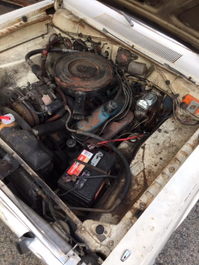

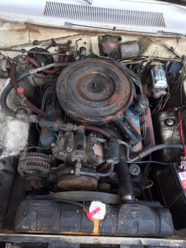

ID:	1247382 ​​​​​​​​ ​​​​​​​One of the very first things i noticed was the massive amount of pinging under load. This early 318 has (had) a timing pointer bolted on the passenger side, it was long gone. In its place was a twisted up hose clamp. Using what was available the engine liked about 5 degrees of timing (didnt check total). Also note worthy, a heater hose ruptured as I was under the hood, lucky for me the rusty water wasnt up to temp.

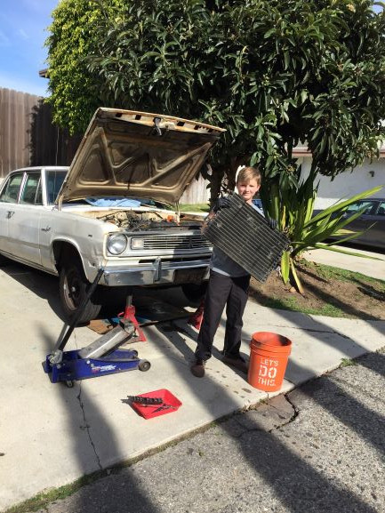

    Knowing that I wont have a major powerhouse with this low compression 318 we decided to remove all extra weight.. power steering, A/C system, entire heater box etc.. The weight of some of this stuff is staggering.

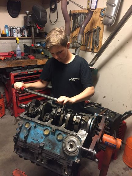

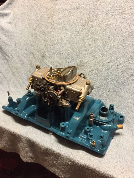

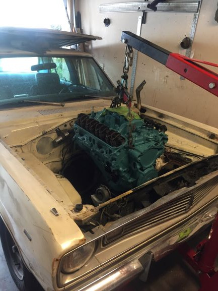

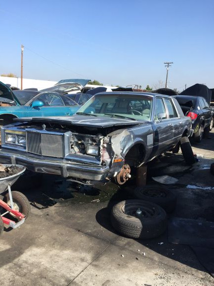

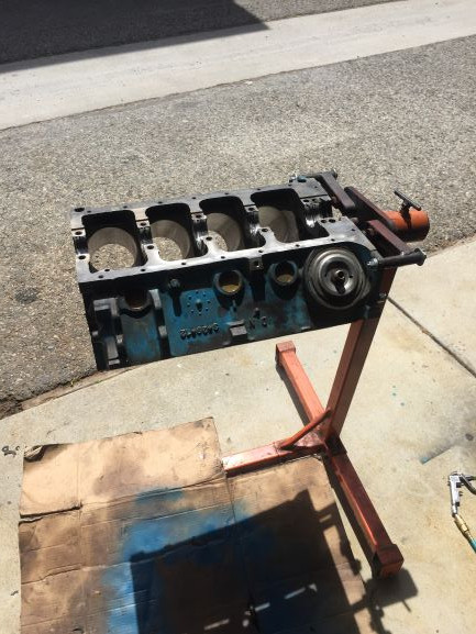

      After the exhaust and manual steering we installed I started planning my top end. I did a compression check and had low 140's in all the holes, the oil pressure was high enough not to trip the dummy light so i decided to leave the short block alone. I score a set of fresh 302 casting cylinder heads from a diplomat in the junkyard. I purchased a comp xe262 cam and new timing chain to top it off. The performer intake was cleaned up and I put a Holley carb that was on my shelf. I did some very basic port pork on the heads and lapped the valves. Planning on running stock springs until after the cam is broke in. I had everything ready to go and had a free weekend, was ready to make it happen. I was all motivated, until I popped the first head off. There was a ridge big enough to catch my nail... I decided to roll with it because its just a beater. That was the plan until I started puling the cam. The cam bearings were in sad shape. That was it, not going any further. I need another short block. After searching around for a serviceable 318/360. With some digging I found a .040 318 disassembled block. Drove down to San Diego to pick this pile of parts up for $140. Spent some time cleaning and inspection, rod bearings and rings were in good condition but the rod bearings had to be replaced. I also added a new oil pump. After a quick cylinder hone job the entire
      mess was cleaned and assembled Click image for larger version  Name:	IMG_1303.JPG Views:	1 Size:	40.1 KB ID:	1247385Click image for larger version  Name:	IMG_1492.JPG Views:	1 Size:	98.0 KB ID:	1247386Click image for larger version  Name:	IMG_1494.JPG Views:	1 Size:	70.4 KB ID:	1247387Click image for larger version  Name:	IMG_1496.JPG Views:	1 Size:	89.8 KB ID:	1247388 Click image for larger version

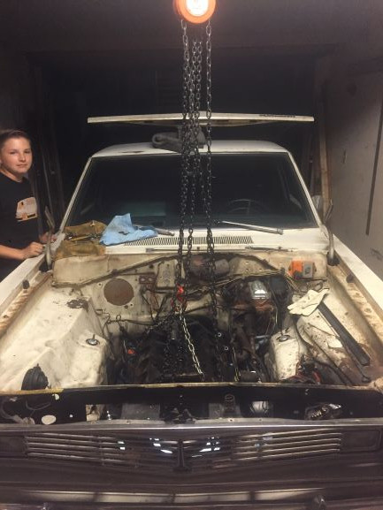

          At this point it needed to be in the garage. So I rented a 5X10 storage unit and moved all of our karting stuff in. That gave me the ability to keep it out of sight while we play in the engine bay. I try to keep everything low key as possible with my neighbors..it can be tricky at times.

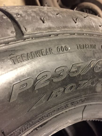

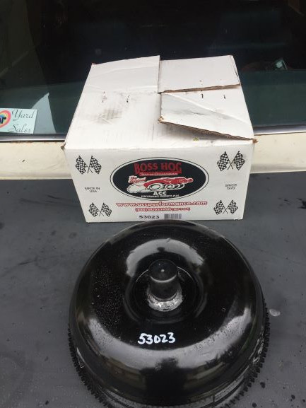

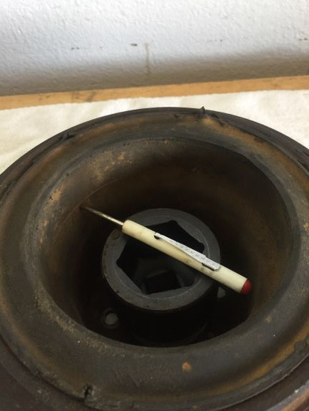

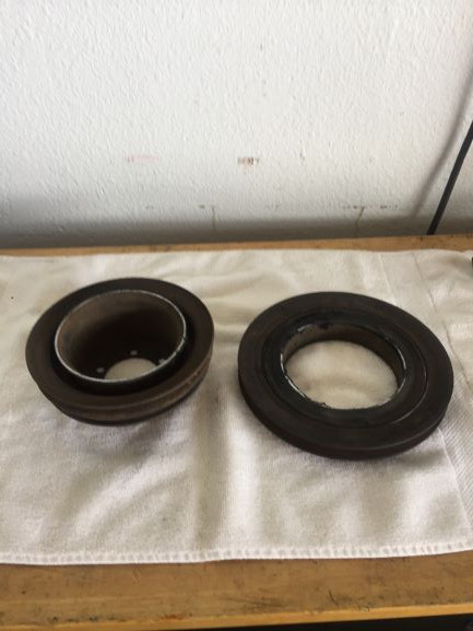

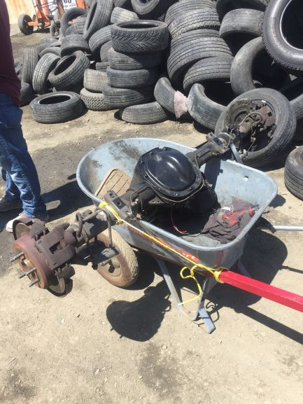

            At this point it was just assembling everything. I was on the fence about the converter. I decided to go ahead and do a mild converter now, I dont feel like dropping the trans in 6 months to swap it. This converter is something like a 2800 stall (memory is slipping), we'll see what we get once its installed. It will all be backed up an 8.8 explorer axle with 3:73s and traction lock (31 spline), so it should be happy together. I also scored a set of new 235/60 drag radials for $310 shipped and a set of 15x7 cop wheels from Long Beach. The rear axle is not really happening just yet. I want to get everything running and driving before head out back.

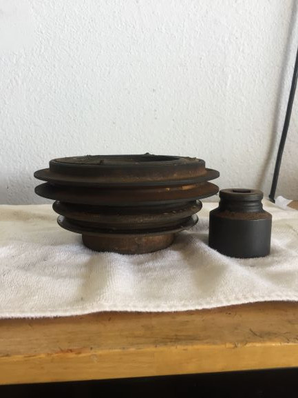

            I also included my cut down Crank pulley, I was looking for a 2 grove but the ones i found were too pricey. After inspecting mine, I realized i could cut it down without wasting the part.

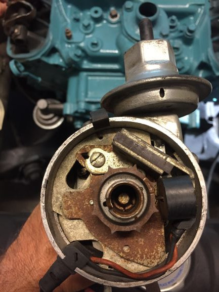

              During the reassembly process i went ahead and took care of the total timing issue these distributors are known for. I used the a timing limiter plate and an old Mr Gasket recurve kit. I used one factory light spring and one from the kit. With the mechanical limited to 18 degrees and my initial at 17, total is at 35.

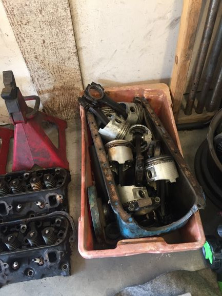

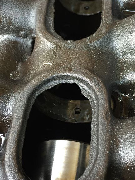

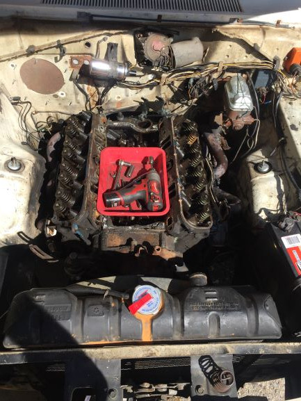

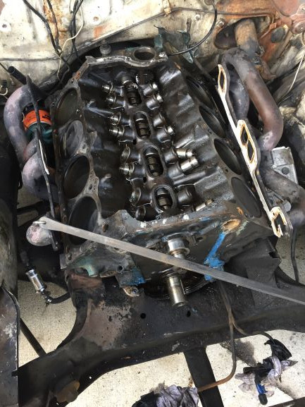

                          After a short break I was able to regroup and take another shot. It ran well enough to move it around but the shudder (miss) and the popping in the exhaust was giving me fits. I decided to perform a compression test. I fully expected a weak or dead cylinder. They were are in the mid 130's, nothing dead but very weak. This isnt uncommon for these 318. My pistons are.090 down in the hole, so even with 60cc heads and thin head gaskets my compression is still under 9. Sucks, but it's what I have to work with. So, as im running my wires back to the plugs ( wires had been previously loomed together with the old zip tie trick) I notice something... I double checked.....DAMM IT! #4 and #6 were swapped! I put everything back where it should be, the idle was great, vacuum was solid at 14 inches and no popping in the exhaust. I spent the last few weeks just driving around and blowing the tire off every chance I get. The other day after a good garage clean I decided it was time to get on with the axle swap. We made a liitle spin around the block, took some pics of a burnout and parked this yard sale in the garage.
