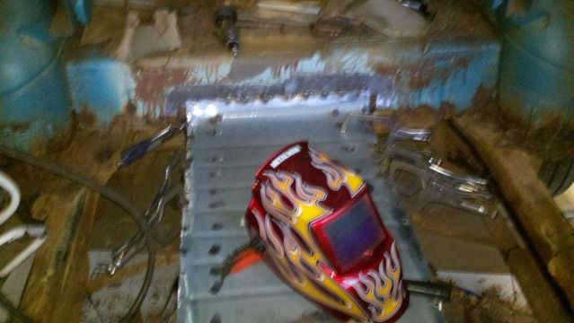

                        Been a while since I have updated so here we go. Still haven't started engine but have been working on brakes and suspension. Nothing fancy except I really like the disc brake kit from Right Stuff. Went together easily and even came with backing plates...nice kit.
                        Front end is lowered, brakes done, new shocks on, front wheels are on the car. Still have back brakes to do.
                        With help from my friend Bryan that can fabricate most anything, we are working on rusty floors and trunk. (sample picture below)
                        The outer body is in amazing condition as far as lack of rust but the floor pans were another story. Rear floor pans totaly flintstone. We have replaced all 4 pans. Hump and metal under seats were perfect. Found a good source for sheet metal...on Ebay...Classicparts4u...Not bad stuff, about 1/2 the price of anything else I have found and the guy ships quick. Made in USA. Currently working with the trunk floor...pictures coming soon...
                        Don
                        "Big cars need lovin too"

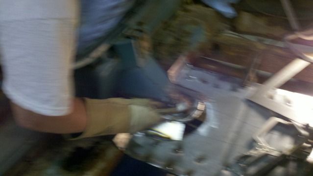

                          More progress...all cancer in the floors is cut out and history. Under back seat and the trans tunnel were in great shape. Can't say that about the floor pans. Had to replace all 4 as mentioned above. Here is the end result.
                          Although the floors aren't totally ready we moved on to the trunk.
                          The entire trunk floor is bad, all braces are good, so the cutting and welding has begun. Amazing how a thin, rusted out piece of metal can hang on with the factory spot welds. Here is where the blood part of blood, sweat, and tears comes in.
                          This is just some of what was cut out of the trunk.
                          The trunk floor comes in 3 sections, so far the center section is spotted in.
                          Tough area to repair, had to fab the section that covers the fille neck, Thanks again to my friend Bryan that has tons more skill in this area than I do.
