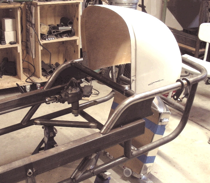

    I'm finishing up on the fabrication of the nose support hoop. And I was working on it this afternoon and have a few concerns.
    I bought the nose about 2 years ago. It's been sitting in various positions in the garage, sometimes on the Whatever project, sometimes on the floor, sometimes at weird angles in a corner out of harms way. About the time I bought it, I made a pattern of the shape of the back of the nose, and being careful to ensure that the shape of the nose side to side was essentially the same. I then made the first support hoop, cutting a sheet of 1/16 cr steel sheet and forming an angle support that matched both the nose and the steel sheet.
    When I shaped the next iteration of the support hoop, I made sure that it matched the curvature. Today getting it ready to affix the nose to the support hoop, I had gaps between the two here and there. And I don't think I'll be able to make them mate up perfectly. This leads to my question:
    If left unsupported in bad positions, do fiberglass parts warp, for lack of the proper term? I'm worried that the resulting gaps here and there will be a problem when I try to bond them together. I have some alternative ways to make the assembly work, so this is for my edification.
    Thanks for any information.

                            Click image for larger version  Name:	20230608_180309.jpg Views:	0 Size:	145.9 KB ID:	1338873
                            You can see the step on the back edge of the nose. The steel support structure is fitted to the inside of the nose at that point. Whatever ends up as my feeble attempt at a brilliant solution has to leave room for the hood and side panels to end up nestled in the step flush with the top of the step. Same with the body. That however is so well supported by the double firewall/engine plate/inner support hoop, that there's nothing I can do to screw it up.
                            So now I'm off to the garage to see if I can have an epiphany. I'm counting on it, but not expecting one...
