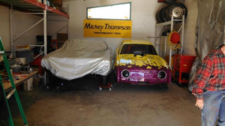

                        One combo I was considering was a 455 buick engine I already have Dyno at over 500 hp , I have a BOP scatter-sheild and 400-455 manual flywheel.....Have complete 5 speed in a 3rd gen trans-am. I thought since you do not shock a trans much this might be a workable combo for Ohio...????
                        I swear this engine was already yellow

                          WOW! You've been cleanin'!
                          As far as the trans - all we can do is try it. Worst case is we'll need something stronger but I think there's a chance at 500-600 HP and reduced shock load (compared to drag racing) it'll live a while. Try it and see, I'm thinking.
