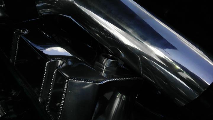

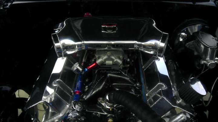

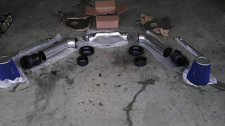

    Is it bad when you purchase an upgrade for your car, than it sits in an unopened box for NINE months!??! That's right, I ordered a Dual Plenum Air Intake System for Jade back in August, and just now put it on over Easter weekend.

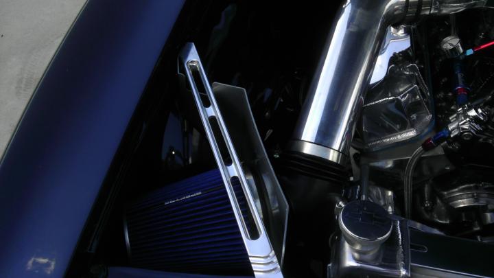

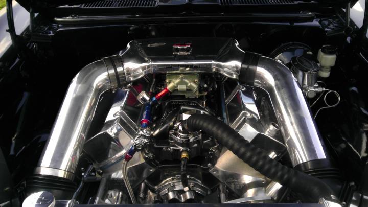

    First, I'd like to say a HUGE "Thank You" to Dave Johnston, Engineer for Spectre Performance, for working with me during this entire process. Not only is this kit a custom made kit for Jade, but they also custom painted the heat shield to match the engine and my Bumble Bee stripe. How's it custom you ask? If you look closely at the pictures, you can see where they made the heat shields to work with my custom billet fender braces. It's a very unique design but worth the wait.

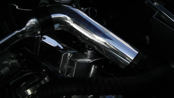

    As of now, I'm having some clearance issues with my valve covers that were handmade, so once again, Spectre is coming through and making me some custom tubes to gain me the clearance I need.

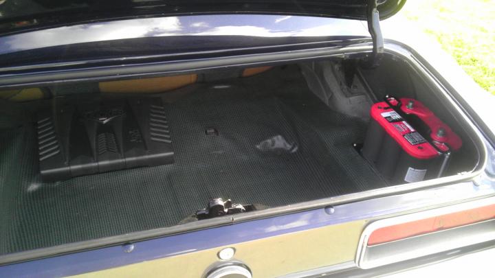

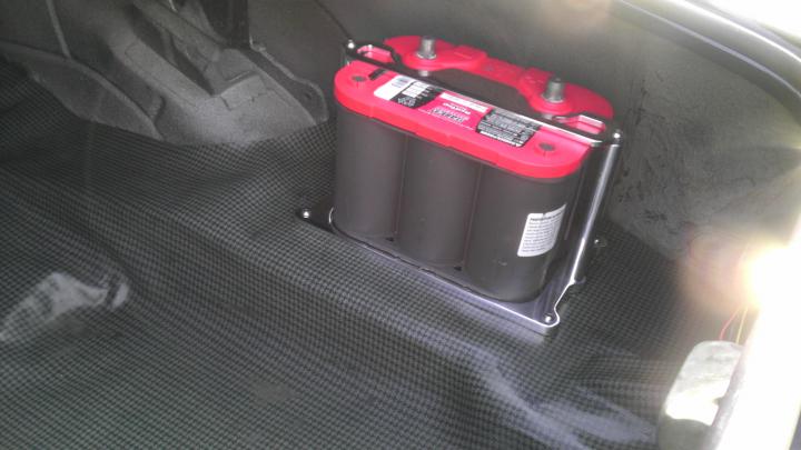

    Of course one of the requirements of running a dual plenum system is, you have move your battery to the trunk. That's one of the reasons I have waited so long to do this upgrade. It was kind of tricky, I made some rookie mistakes, but all in all, I think it turned out really nice. All the wires are hid, and tucked away nice and neat.

    Bucky,Awesom looking. I love the support arms.That Easter Bunny was very good to you.. But one thing, cover the battery terminals. I'm guessing you are using the side mounts but you need to cover the top mounts. Can't wait to see you again brother..I hope all is good with you.

      Rett, thanks brother, I appreciate the compliments. You are correct, I'm using the side post to hide all the wires and make it look as clean and professional as possible. However, I'm still trouble shooting a bad ground, so I have the top post uncovered temporally. Once I'm completely finished, I'll put the Optima cover back on top for a clean, sealed look.
      I had the support arms custom made and I think they turned out awesome!! I had to send them to Spectre Performance to have the heat shields cut to fit the arms. I was skeptical, but man it looks good. She's not fully finished, but close....

                          Thanks again for all the compliments!! As of now, Spectre is making a LOT of changes to clear my custom made valve covers, so it's not completely finished. The boots that attach the polished aluminum tube to the air filter are 60 degree boots. They are making 75 degree boots to allow for a longer tube coming off the plenum air intake. We are also changing the degrees in the plenum air intake from 120 degrees to 135 degrees in order to clear my breather all while keep it away from my Wilwood Master Cylinder.
