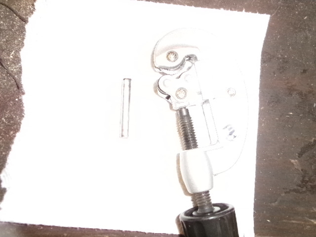

    For the places where a push pin goes through the carpet, I cut a piece of brake line long enough to go into the hole and stop and I'll push down on the carpet to make a hole for the push pin. Is this something I invented or it this something like what everybody's been doing for hundreds of years?

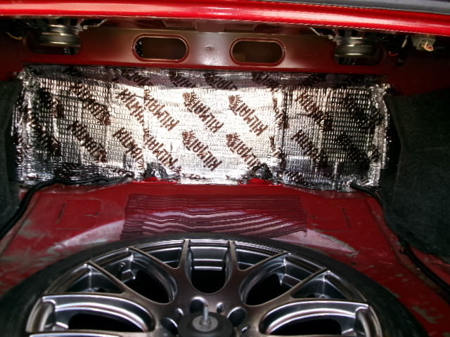

    Well, there it is. An ugly but very effective fix for the mess I made with that piece of wood. It's now really solid, it'll never rumble and rattle again. I LIKE it. My only concern is, when I take Red to the Concurse Duhlegance car show, will they make me open the trunk as part of the judging?
    And after 4 days of silver sticky rubber panels I nearly forgot (and Unit DID forget) why I even flew into doing all of that. The next step is another thing I've definitely never done before. Thanks to the YouTubers, I think I can do it...
