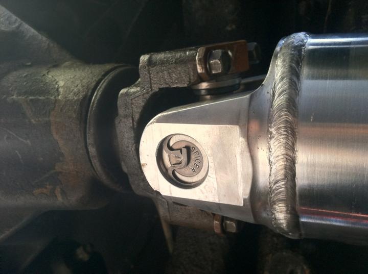

      Brian, how long is the drive shaft? I just measured the one in the Skylark and it's 43.5". Curious after our conversation at March Meet.

        Just about 55" from the ears on the rear to the ears on the front.

          Slight hi-jack. On another forum I check out from time to time (gasp!) someone is asking for some driveshaft tech and posted this chart up which I had seen before but never really analyzed given I did not know how long my driveshaft was (considering it's been shortened two or three times). What I first found interesting about it was it doesn't go as low as mine, and even then it starts at 9,000 rpm for 3" stuff. Which of course mine isn't even 3", it's probably 2.5. Looking at the mild steel, a .5" reduction in diameter shaves off around 1,500rpm on the critical speed, which would trend towards mine being 7,500rpm limited, which it'd never see with a BBB in 4th and would be 4,800 rpm in overdrive. Which would be 170mph in either gear with my 3.42's and 142mph with an extreme for me 4.11's. I'm going to copy this to my thread too
          I forgot if your driveshaft was already 3" or if it was less? Either case at 55" the chart makes it look like bad news around the 5,500 rpm or less mark and you got evidence to back that up =/

            It never made it to 5500....but the junkyard one in there now has done it probably 15 times. I am beyond lucky I didn't have another disaster.

                              Little Easter morning wrenchin'! No mo driveshaft worries. Shameful to hide this monster!
