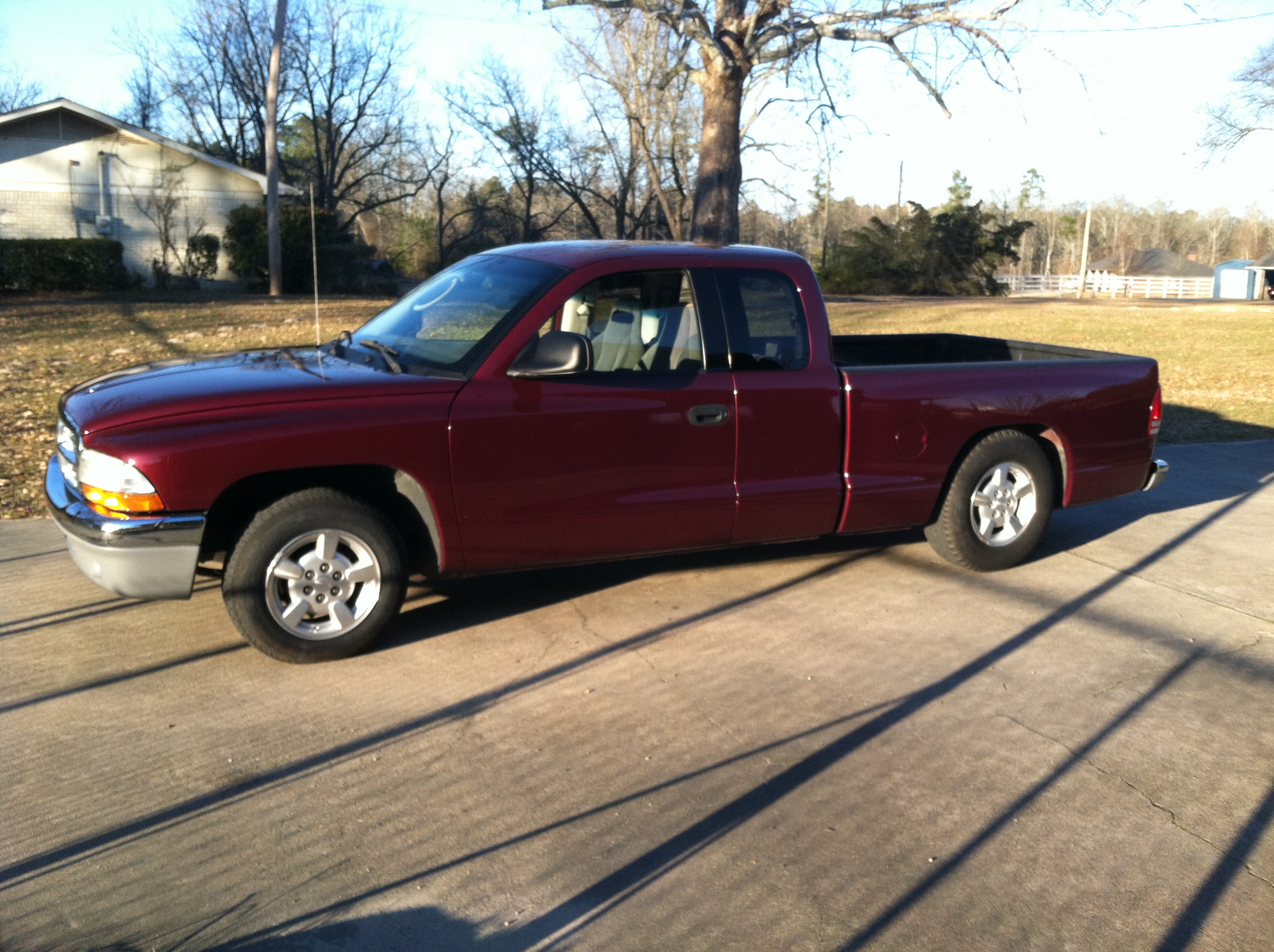

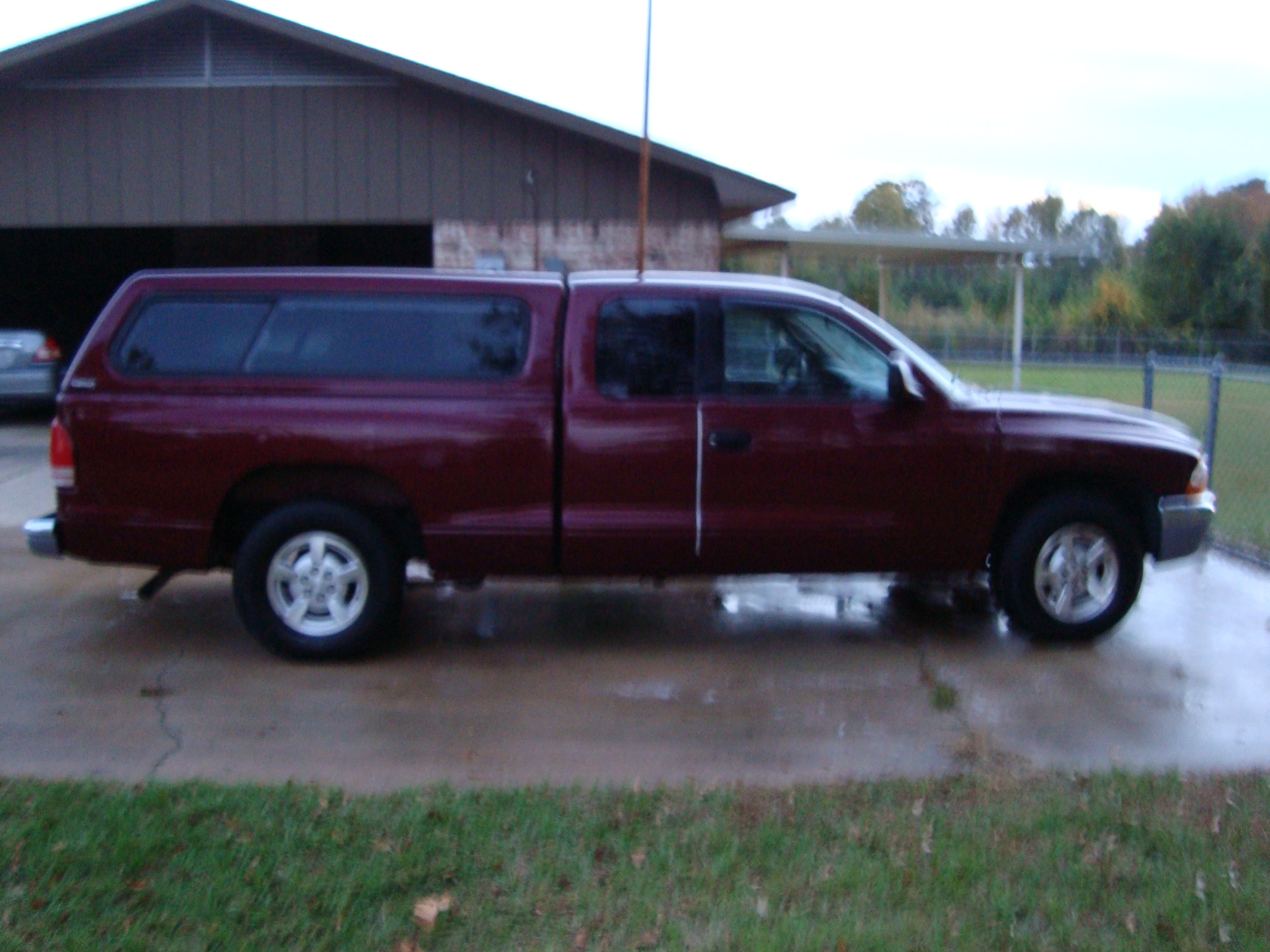

    Hey guys I'm new here and thought that I would make a build thread for my truck. It is a 2001 Dodge Dakota v6 that I inherited from my grandfather.
    Here is what it looked like when I got it.

    I then built a sub box and installed the sound system. I don't have pics they were on my last phone. I also removed the camper shell so that I could actually use the bed. About a year ago I lowered it 4 inches in the rear and 3 inches in the front but the springs only lowered it 1.5 inches because they are v8 springs. I was thinking ahead.

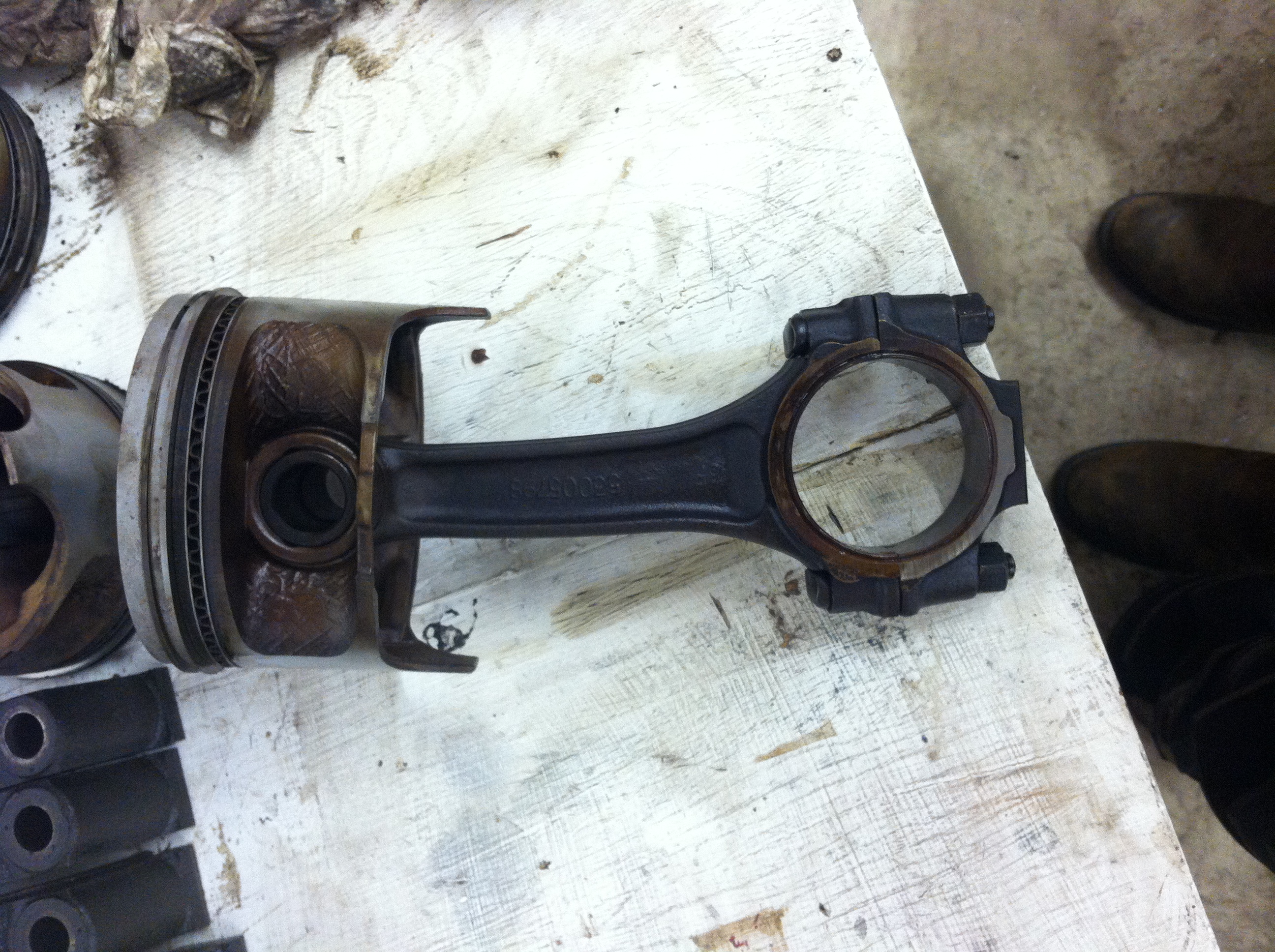

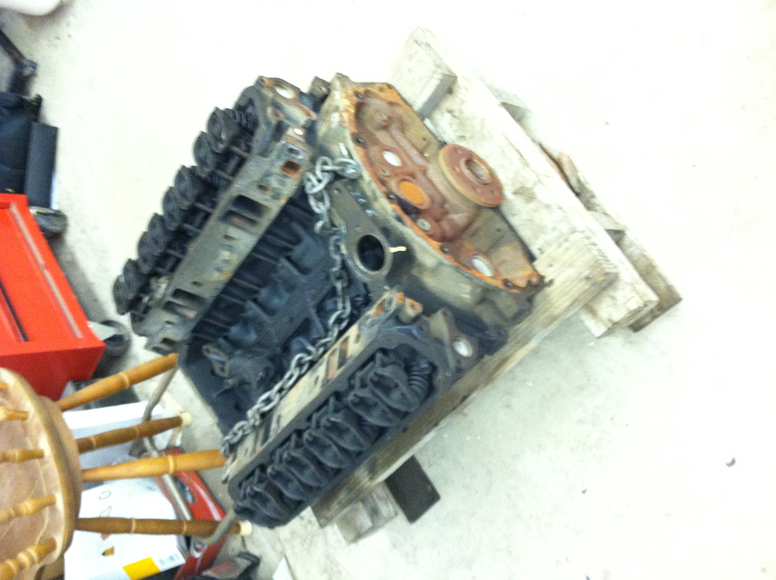

    I bought a 360 magnum from a guy that said it had overheated and wouldn't start.
    I tore into it and this is what I found. A bent rod.

    The block was sent to the machine shop and bored .020 over. And I painted it Hemi orange.

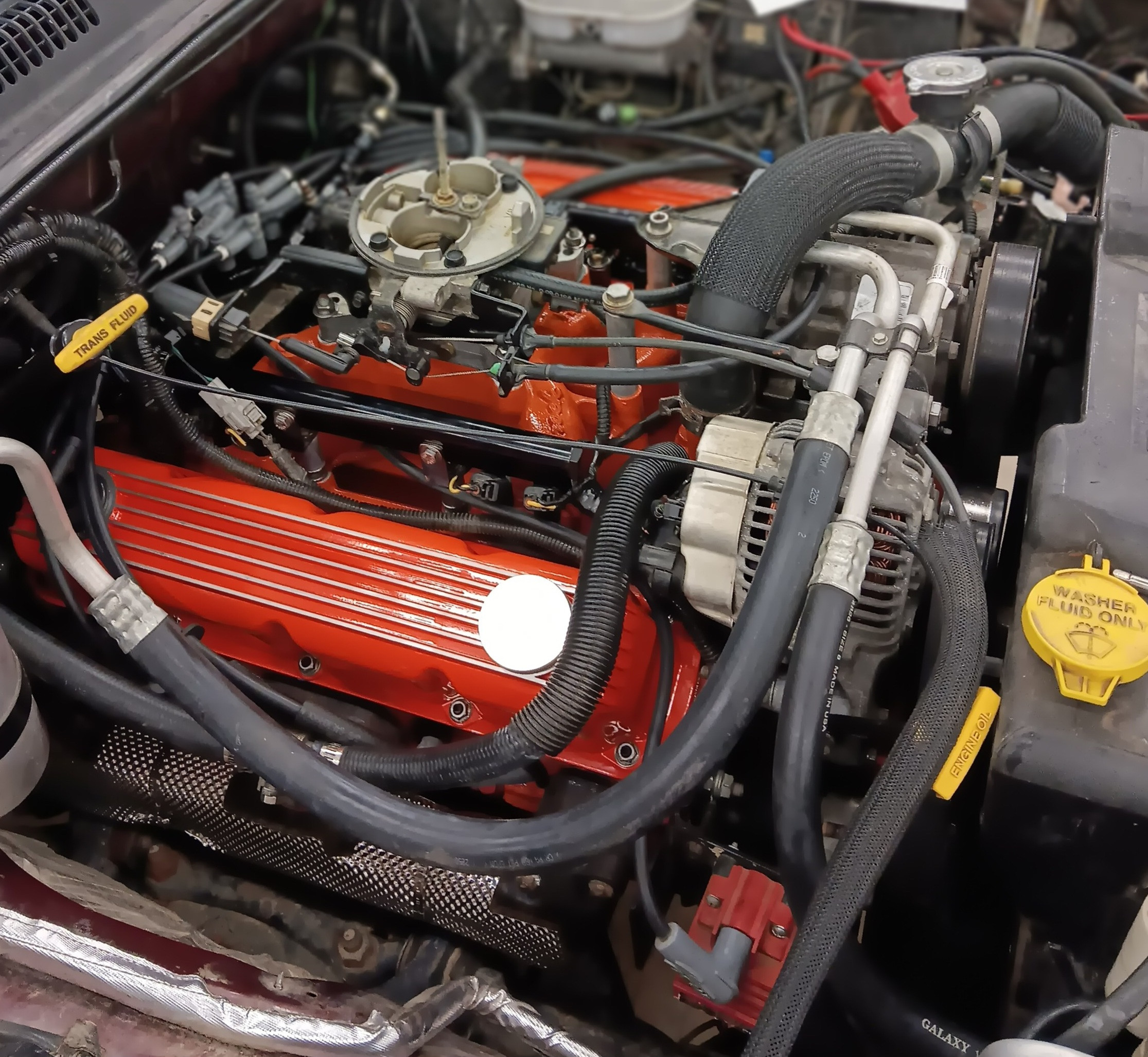

                      I always said that I would never let life get in the way. Yet here we are. I'm reviving this thread. My vision for the truck has changed through the years. The truck has also gone through different incarnations. While I still want to compete in Drag Week with it, I am not building the truck specifically for drag week. At one point the lowering kit came off so I could use it as a truck and the 408 grew up a bit and is now designated for my Scamp. I am going to make the truck look original but perform better.
                      I swapped a 360 into the truck a couple years ago. And have gotten it ironed out. Its a .040 over magnum block with the iron heads that were originally on my 408. It has a small Comp cam and an Edelbrock air gap that my dad added injector bugs to. I also added an MSD 6 and a Blaster ss coil. I slotted the crank sensor so that I could adjust the timing, which really woke the truck up. I'm currently waiting on TTI to make a run of long tube headers or find a set of Spintech mid length headers.

                              The cam that I originally used was a small Hughes roller grind. After approximately 20k miles it developed some wear so I pulled it and replaced with the Competition Cam as well as switched from roller tipped SBC rockers back to the original pedestal mount rockers. I also added a pair of Ansen valve covers and have since installed a 53mm throttle body.
