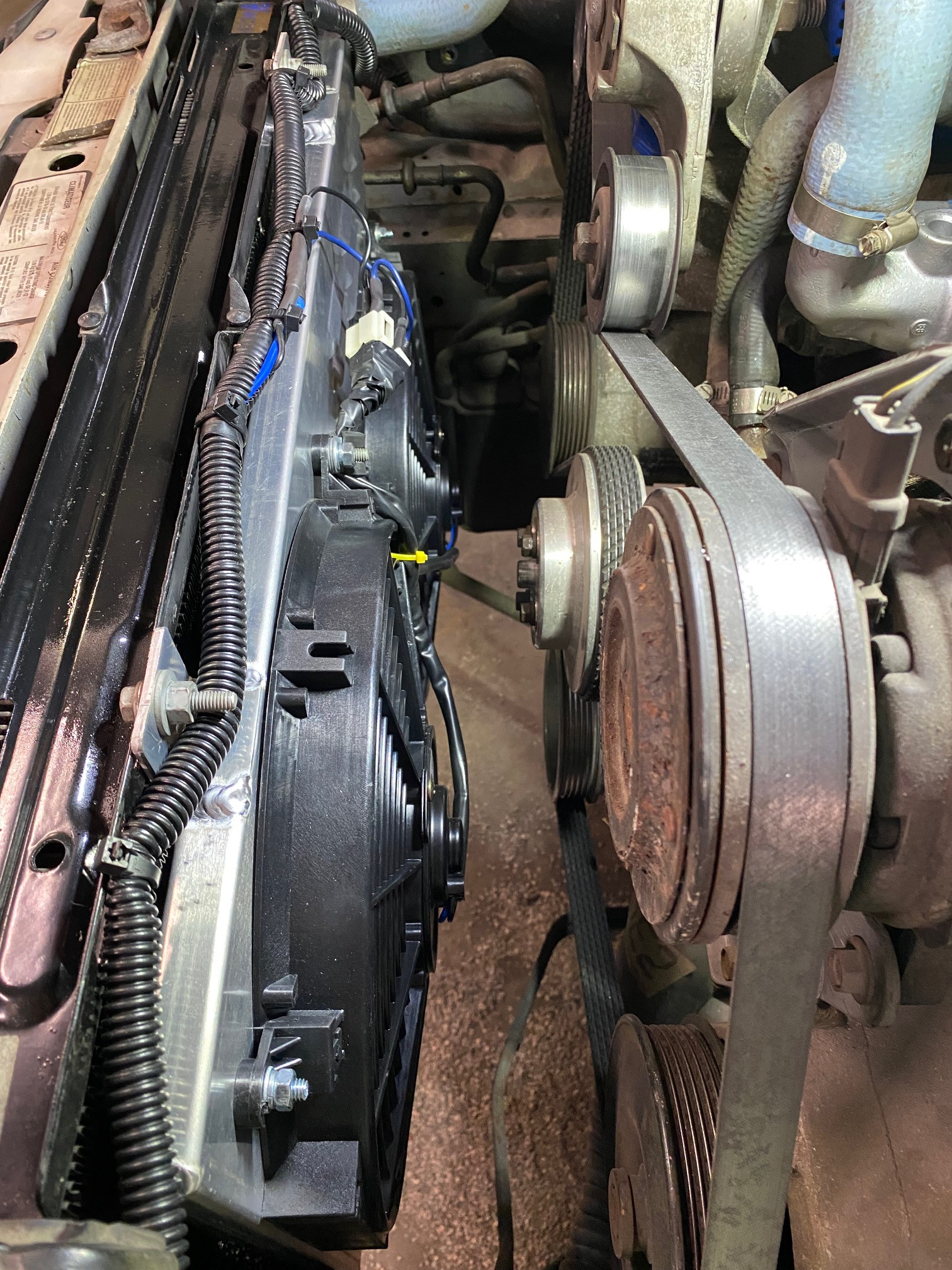

                  I took Stanger on several drives and worked out that clutch fan has crapped out (sorry for the technical jargon). I went back and forth between replacing the fan clutch or going electric. I found an Ebay source with a direct replacement unit that I could just bolt up and run - NOT! But sorta close.
                  The top bolts almost fit thye aftermarket radiator tank bolt slots but not quite. A little rat tail filing and I was there. The bottom was about 2 1/2 too close to the top to ever bolt up so I made a couple of aluminum angle pieces and found holes to bolt them to. Worked fine but there was some fabrication.
                  The sparse wiring instructions were - well - weird. It came with a relay and fuse/fuse holder which is good but they really threw my for a loop. I wired the relay as usual but the fan was coming on with the switch. Took a while to sort that one out but as I looked at it they had a ground terminal with just the right length pigtail to bolt up to the relay mounting screw and that was in the line to the temp sensor. Can't believe it took a few minutes for the lightbulb over my head to light up but, of course, that ground shouldn't be there. Dunno why they did that..... Anyhow, I ungrounded that circuit except thru the temp sensor and all works properly. I even heated the sensor up with the heat gun and made sure fan came on and it does. As I was nearly done I realized I did a bonehead move as I could have caught the B+ power off the starter solenoid which is on the left shock tower instead of running a line up from the starter. I simply had forgotten that I had Big Power right up near where I installed the relay. Oh, well - next time.
                  All in all, for $104 and NC tax it was a great deal and seems reasonably made. It ain't Spal but not bad. Tomorrow, weather permitting, I'll take the Ol' Boy out for a spin and make sure he stays cool which I expect he will.
                  Pics of the installation:
                  Click image for larger version  Name:	IMG_1414.jpg Views:	0 Size:	978.3 KB ID:	1326642
                  Slightly different angle. I wanted to show how much more accessible the front of the engine became.
                  Click image for larger version  Name:	IMG_1415.jpg Views:	0 Size:	980.9 KB ID:	1326643
