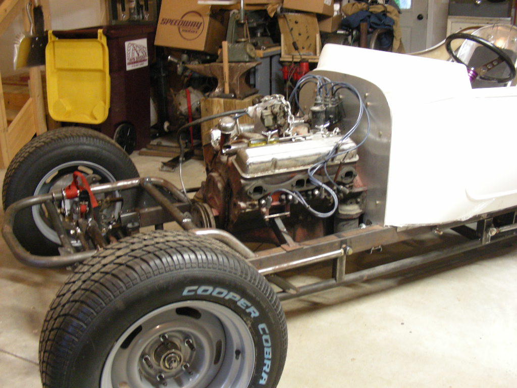

                                Today I got the 283 in the engine bay. Here's a couple of pictures of the progress today.

                                Now I was thinking about running the exhaust inside of the hood and side panels. That's out! Look at the 1st picture. Draw a line in your mind's eye from the cowl to either one of those little tiny tabs on the crossmember in front of the engine. That's approximately how wide the nose is, and where the front of the side panels and hood would come to. And also there's a steering shaft down there halfway between the frame rail and the engine. Fortunately I also have a backup plan, plan b. That's just assemble the 2nd header kit as it was intended, sprint car style. And a quick look at the clearance this afternoon showed me that the tubes will be a couple of inches clear of the suspension components outside of the frame up front. And the collectors appear to line up with the lower frame tubes. So I can run 3 inch tubes alongside the frame to behind the body. And insert mufflers into the tubes.

                                Looking at these last 2 pictures, you can see that the clearance needed for a fan and the distributor worked out rather nicely. And there's no problem with the tight clearance at the distributor as that firewall/engine plate assembly is overkill and it will not allow the engine to move at all. And the fan can get closer to the crossmember in front of it, same thing. It'll never hit it. And the radiator is on the other side of the crossmember, so no chance of the fan meeting up with the radiator, unless it's REALLY bad! And I probably won't care if that were to happen. Well, at least if it was me driving...
                                So headers have been decided on. Engine mounting worked out. I'm going to make a set of front motor mounts that look better than the current setup, but won't change any clearance or engine orientation. Nuf said for now...
