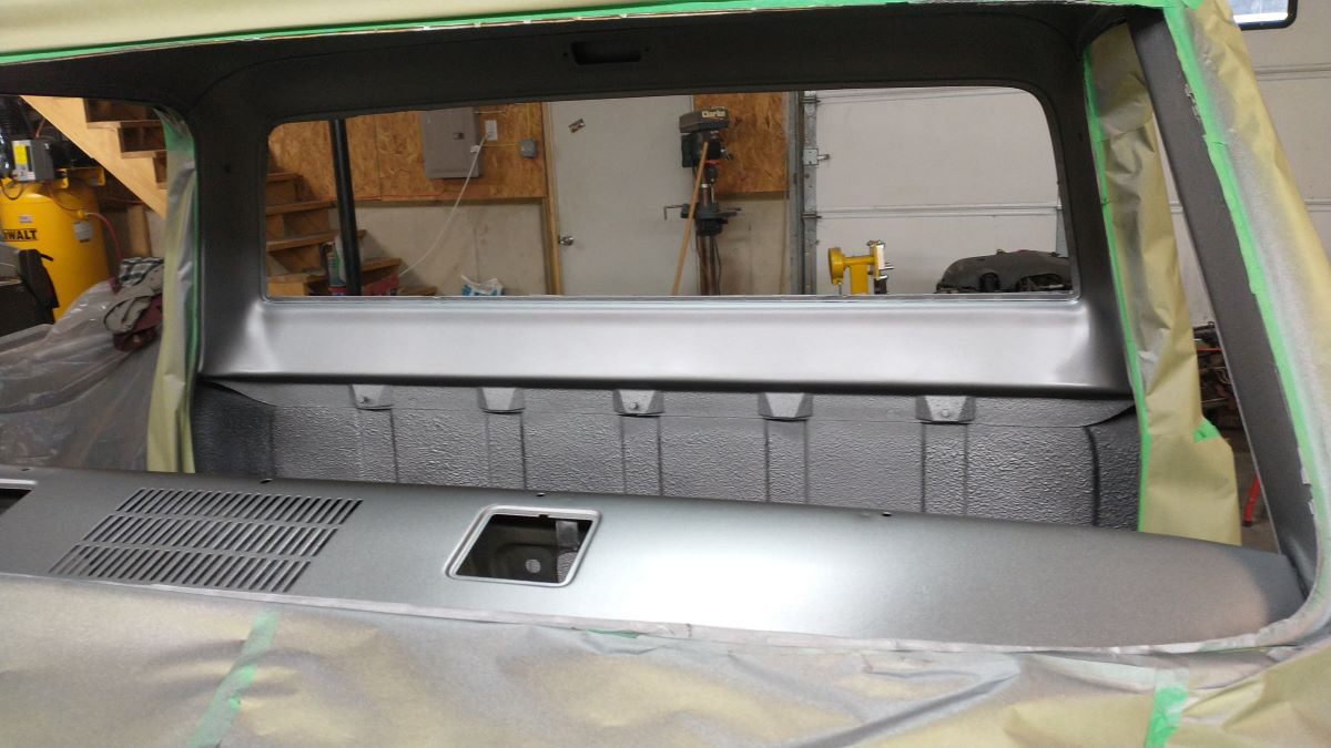

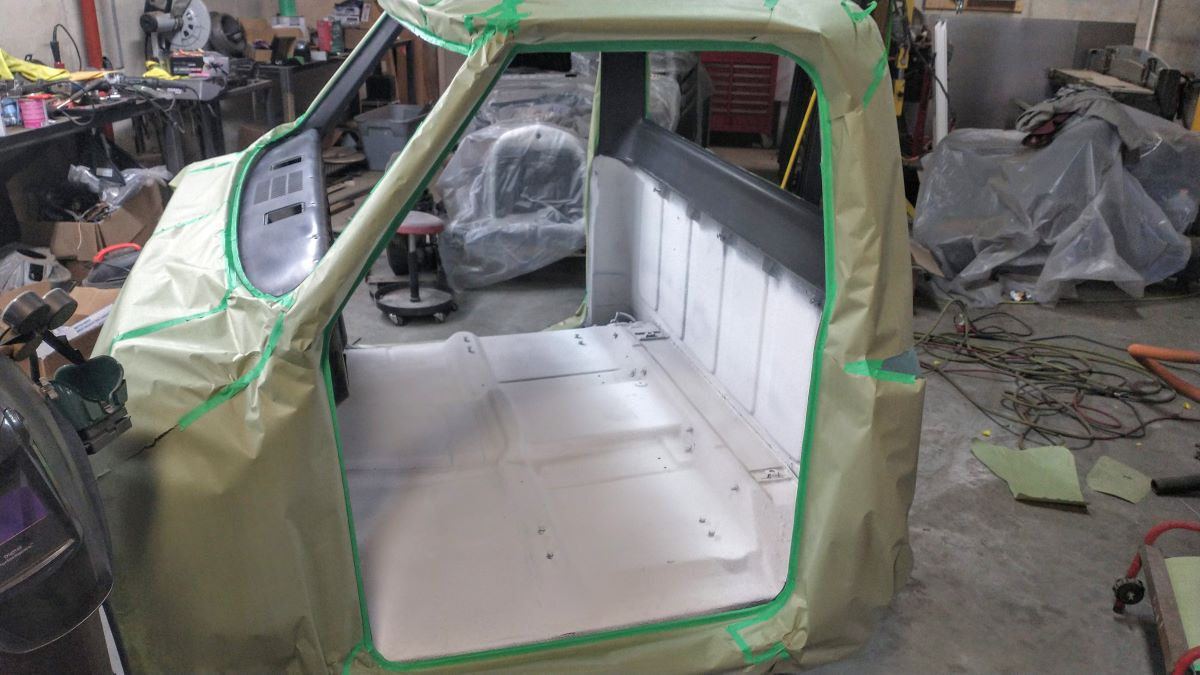

          If you are going to find any green on this cab now, you'll have to work for it.
          Epoxy primer and 2 coats of Lizard Skin noise barrier. Once it cures (24-36 hours minimum), I'll add the heat shield to it.............I hope it works

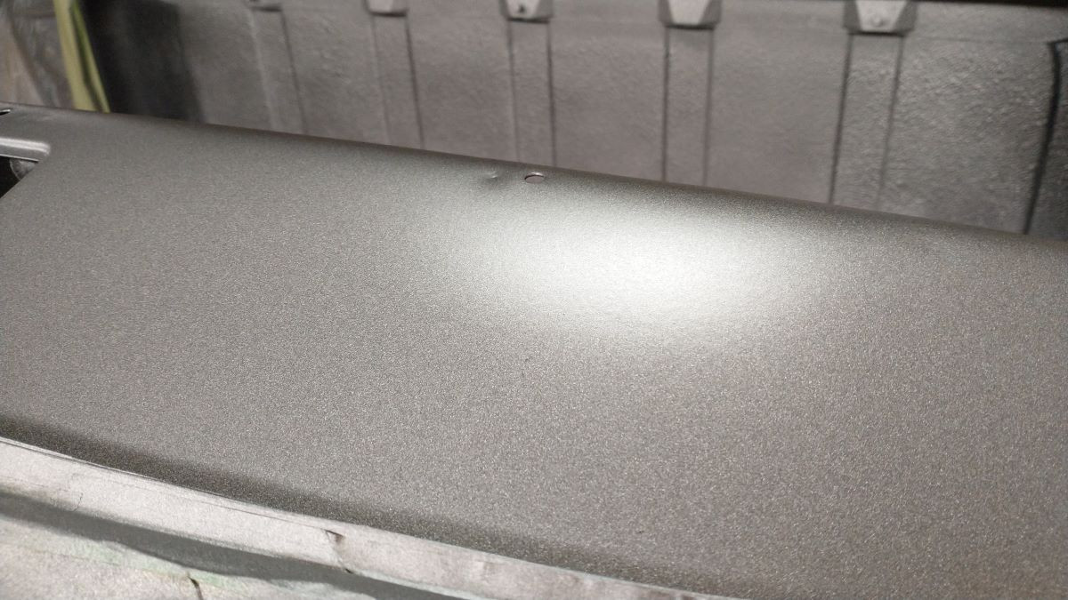

                        I was out of the shop for over a week, but made a bit of progress today.
                        Last week I got the ceramic insulation on at the last minute.
                        Today scuffed the epoxy, and touched up the inevitable burn though spots, and slammed on the galaxy silver metallic satin paint.
                        It's Hot Rod Flatz brand single stage urethane. It's sure hard to see in there, I hope there's not any bare spots

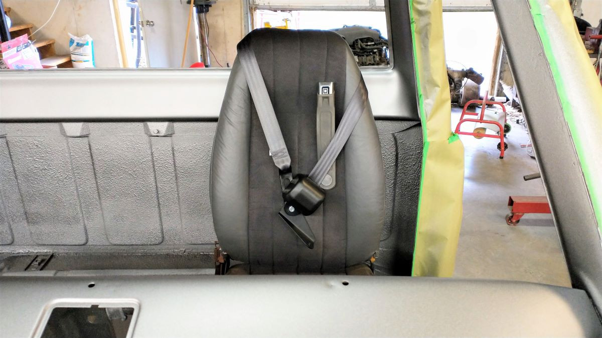

                            Looks like the interior color, seats, belts and carpet will work out.

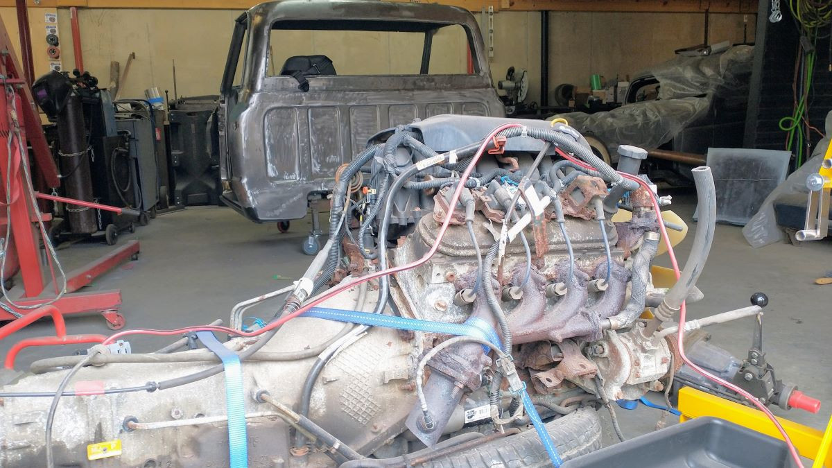

                            The lq4 is taunting me. I just sent the pcm off to be vats/smog deleted. If it runs as promised, I'm gonna bolt it in.
