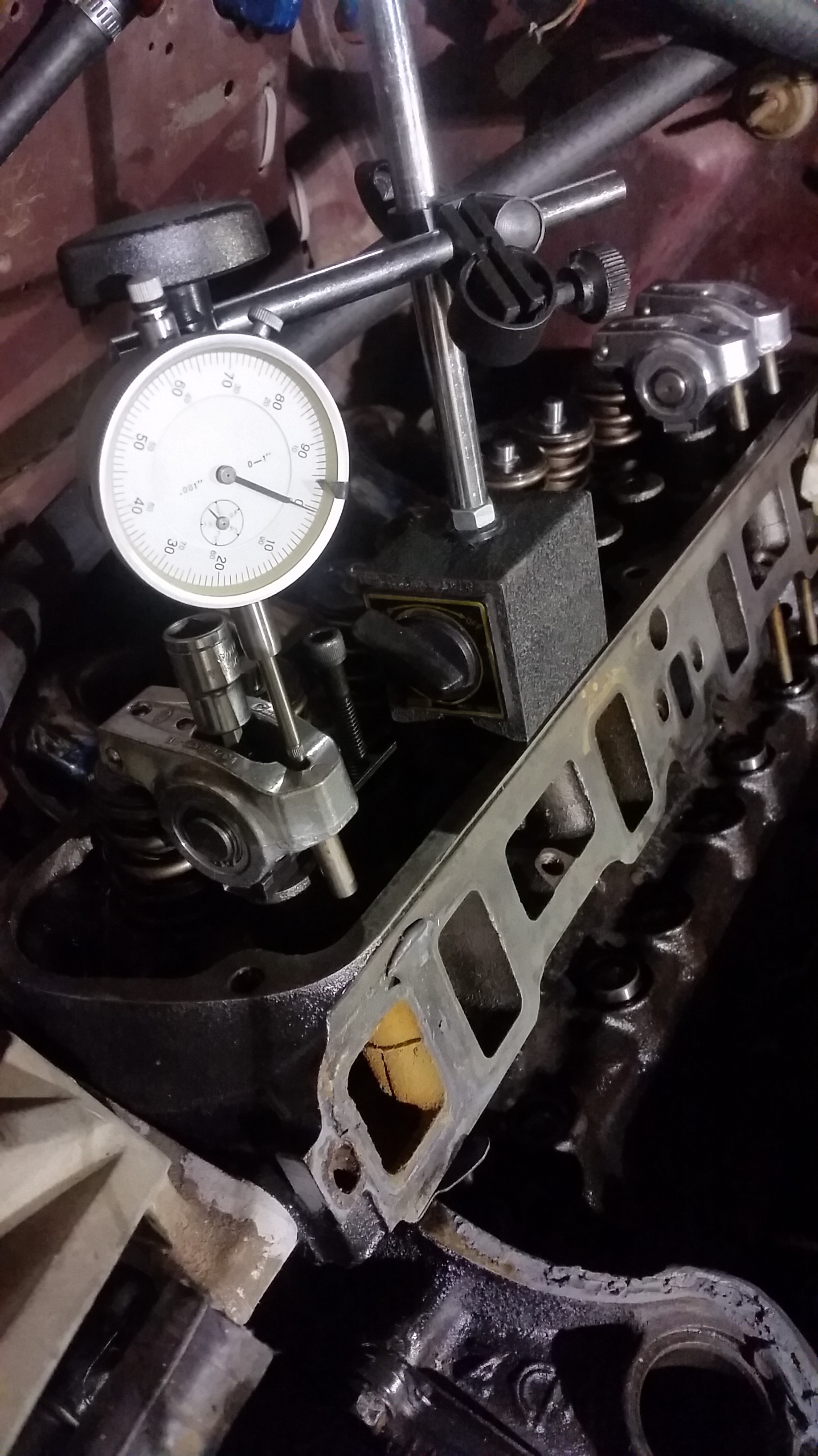

Off came the intake and everything so far looks good. Lifter faces on the passenger side all look great. I decided to check my lifter preload because I didn't have a clue what it really was. I disassembled the lifter, drained it (because it was rock hard) and set up my dial indicator. The verdict: 0.045". A skosh more than I think I should need, but that is easily corrected.
I really think I will throw a new set of lifters in it while I am here. I am seeing that these Summit lifters do not have the greatest reputation.
Last edited by BBR; April 29, 2018, 04:44 AM.Life is short. Be a do'er and not a shoulda done'er.
After doing a TON of reading on how hydraulic lifters work (and don't work), I concluded that these lifters are randomly collapsing once the engine gets up to operating temp. Some have crutched this by running heavier oil, but I had 10w40 in it already. I could go to 20w50, but oil pressure has been good so I'm not ready to go there just yet. The collapsing is further exacerbated by the the stiffer valve springs. I chose these springs (TFS-16514) in order to match our installed height. Supposedly the fix is to run an anti-pump up lifter. These lifters have tighter internal tolerances and are less likely to bleed oil off, collapse and cause clatter. I ordered a set yesterday. Hopefully this will fix our problem. It is irritating because it runs and sounds so good when cold!

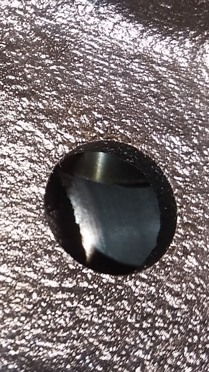

Bummer. Cam is dead. 15 lobes/lifters look great, but #5 exhaust lobe/lifter is toast. We will feex.
Yeah it sucks. I neglected to use any sort of break-in additive and it bit me in the butt.
Additionally, #5 exhaust is the last lifter to get oil on that side in the oiling system. I'm going to make sure the feed galley is not gooked up or something.
Strangely, #5 exhaust is not one of the ones I remember making noise. lol
I already have the new lifters, so I ordered another Summit 3601 cam last night. Hard to beat a $72 camshaft. lolLife is short. Be a do'er and not a shoulda done'er.
