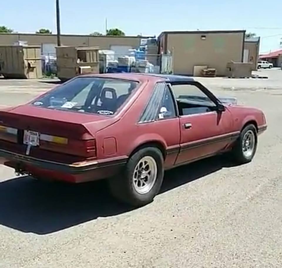

Horrible screenshot from a Snapchat below
SUCCESS!

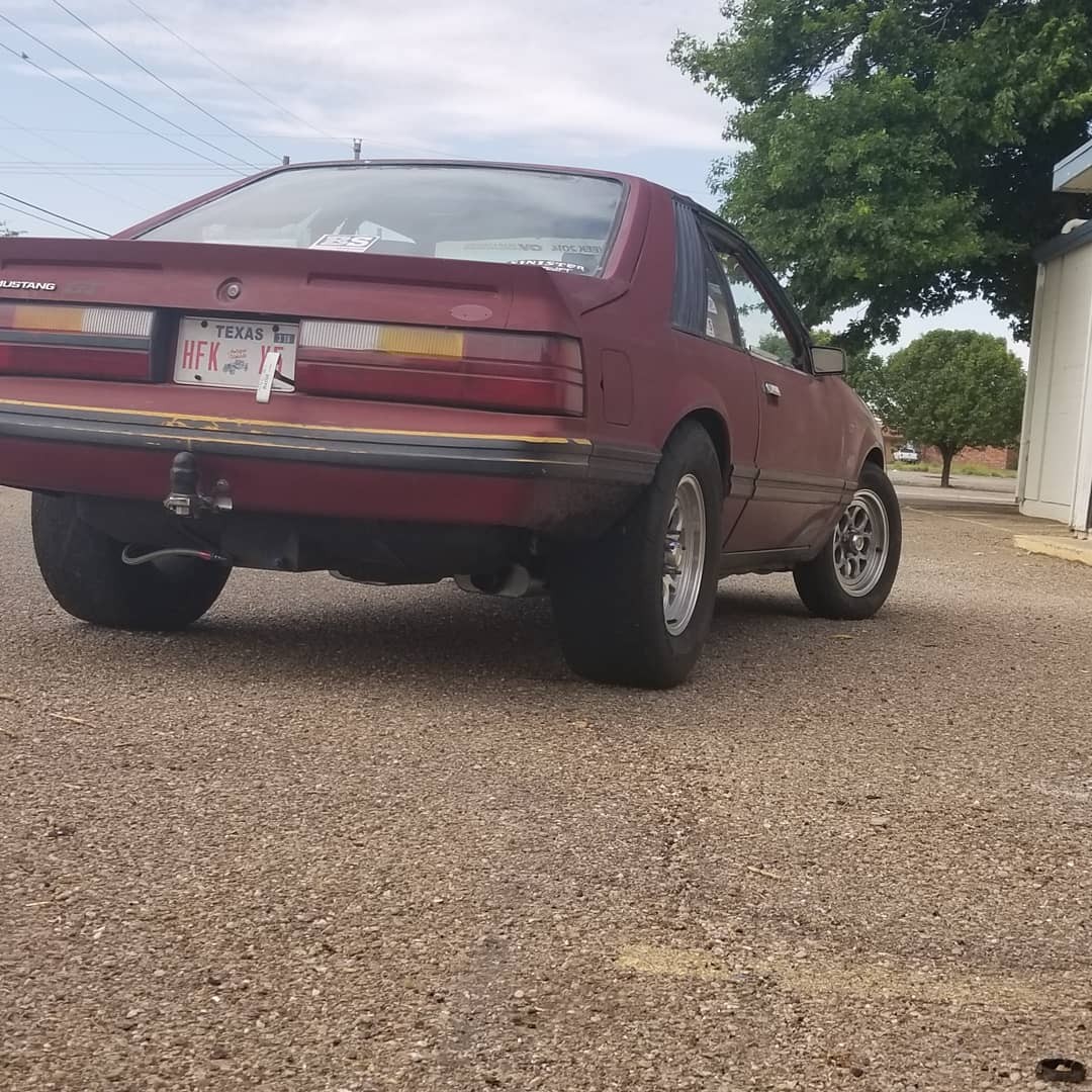

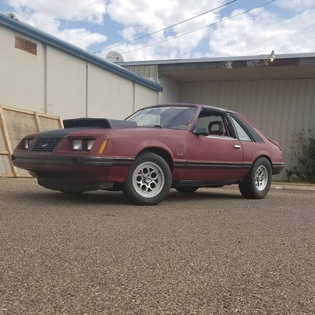

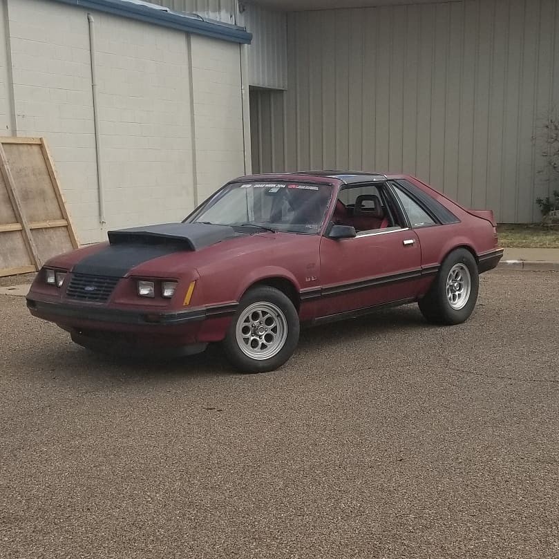

Jake took some pics!

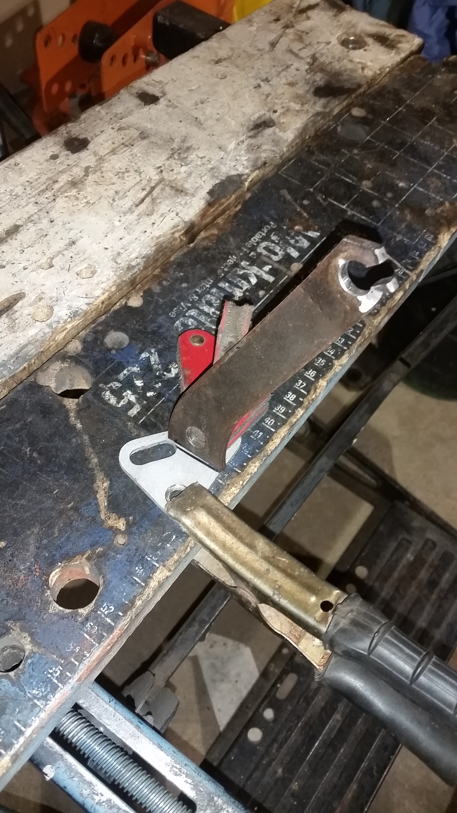

We had to change the throttle cable to a stock one. The aftermarket cable decided it didn't want to slide any longer. It locked up solid. I bought a new stock one at O'Reilly's and had to fabricate a mount. I added a triangular support to it after these pics. It works like butter and is adjustable. A 1000% improvement.
We brought it home so Jake can drive it to school on his last day. If it's raining it will have to stay home because the t-tops leak, it has no wipers, it has a TIGHT limited slip and it has drag radials.
Great success. He drove it to school and ran around in it yesterday without any problems. It does have something that is draining the battery if you leave it connected overnight. I am suspecting it is the voltage reg because I read where they can do that very thing if they go bad.
It is supposed to be 99 today so I might get it out and drive it down the highway to see if it will stay cool, not boil fuel, etc on the road.
Haha.
It was hot. So I made Jake drive it down the highway and it passed with flying colors.
