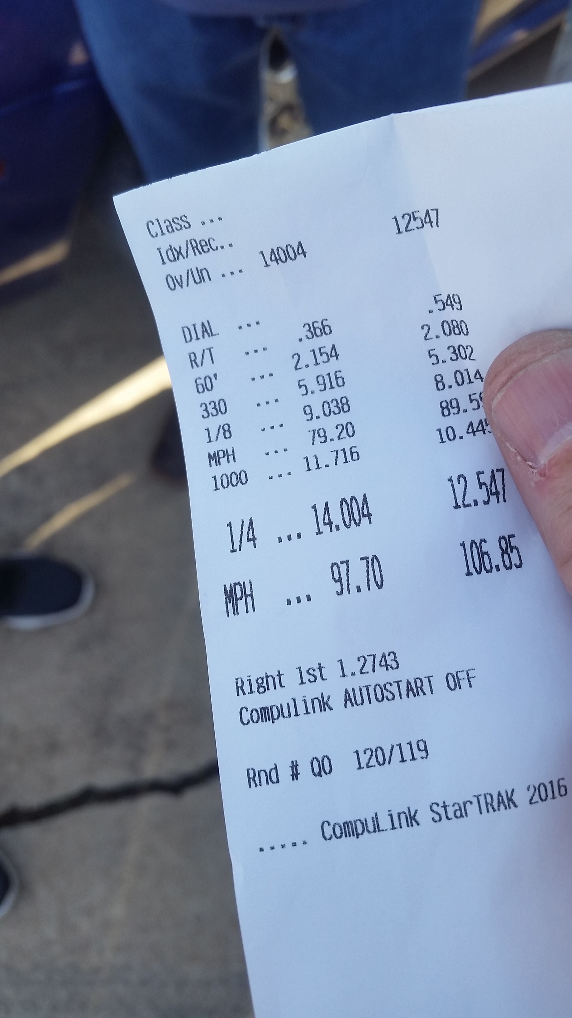

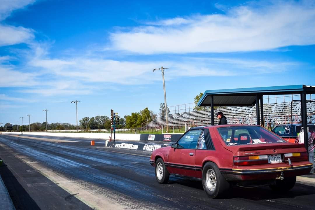

Holy cow what a fun day. Jake, Judd and I left Amarillo at 5:30am and drove 250+ miles to Thunder Valley. Got there, got teched, and we both made passes. I made a baseline n/a pass the first time up. 14.00 @ 98. Bogged it a little off the line, but was very happy with it. Jake was running on street tires and ran 14.86 @ 95. The lanes were full so we didn't get to run next to each other. They had multiple down times so we only made one pass before the lunch break.
We pulled some timing and went back up with the "150" jets in it (59/59). It revs so fast in 1st on the hose, I missed 2nd, but it went 1.75 in the 60 and ran 12.68, so I was pretty optimistic it had a low 12 in it. Hot lapped it back to the lanes and Jonathan and I got paired up! Whoo hoo! Nitrous 302 vs. nitrous 302, both 5 speed cars, but his has better heads, cam, intake, and headers. I tree him, we ran identical 1.80 60's and we were dead even at the 330, but then he just motored on by. His car scoots!

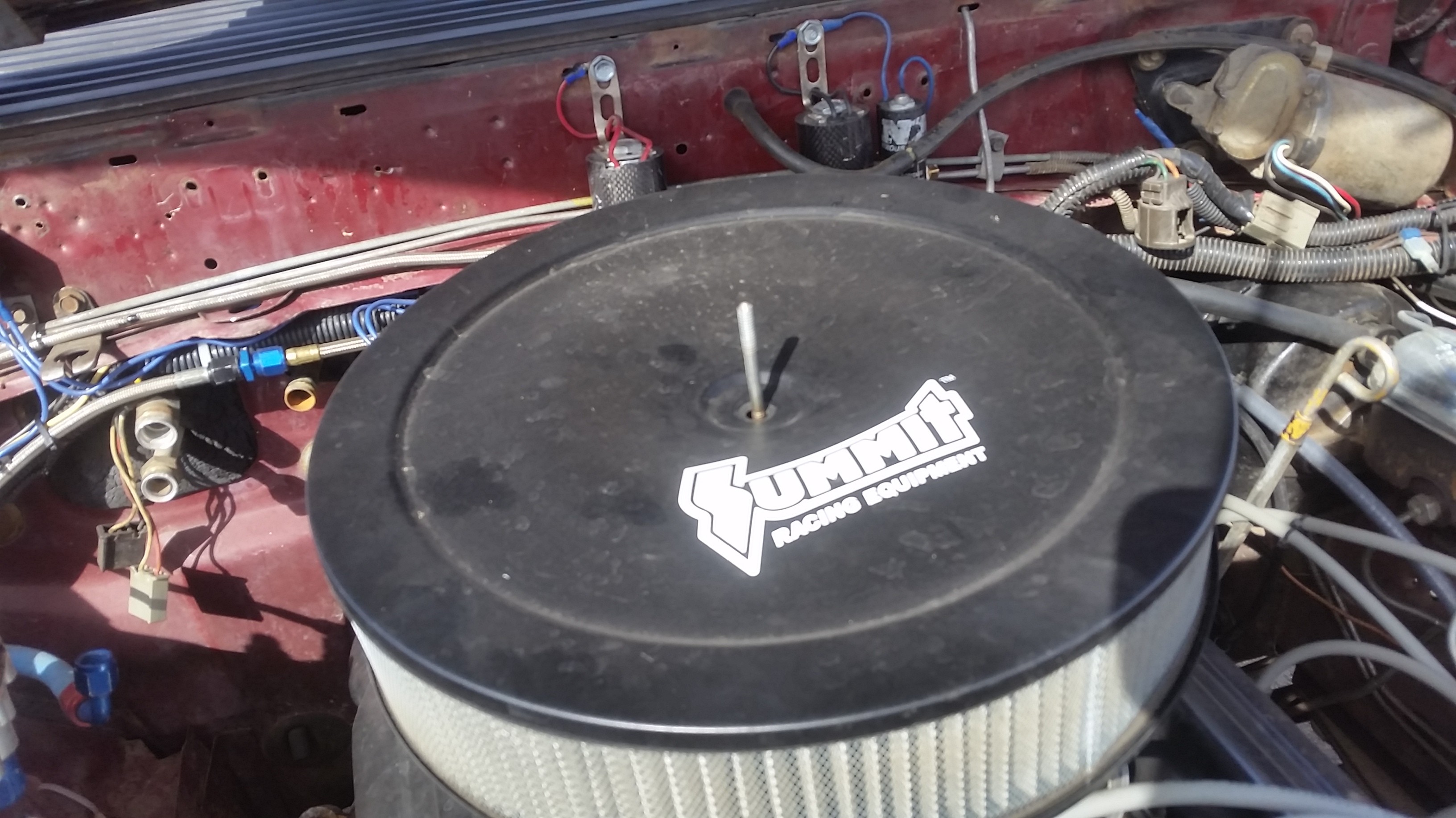

I ran 12.28 @ 113 to his 11.40 @ 123. 12.28!!! I was soooooo stoked! They were saying they were going to close qualifying at 2:30, so I went back to the lanes again. This time was not as successful. I overrevved 1st or something and had a BIG nitrous backfire that wrecked the air filter lid and popped the hood. Haha. Singed the inside of the air filter and some wiring around the carb. lol Yowza. Went back to the pits and looked everything over and straightened the lid out with a hammer.
I upped the shot to 62 jets and I got paired up with a 12.5 second Cadillac. Got in the car and headed to the lanes for my group. Then disaster struck. I TOTALLY brain farted trying to remember which way was ON for the nitrous arming switch. It is supposed to light up, but I couldn't tell in the sunlight. So, I guess. Turns out, I guessed right, BUT I forgot to purge, so when I launched, it felt slow, so I wacked the switch, by which time the Caddy was way out on me. I lost. Bummer. But it did run 13.75 @ 101.
Car ran great all day, Didn't leak, water temp and oil pressure were super consistent and I drove it on the trailer at the end of the day. That is a total win. Jake made several runs and tried the 275/60 tires from the 83. He never bettered his first pass though. In the finals, his Buick didn't show so he had a bye.

Ford won by a landslide 49-11. Hung out with John (Gateclyve Photographic) some. He made a pass next to Jake. We got loaded up, went and ate with friends and got home around midnight. It was a looooong day.
Some awesome pics from the day from Jonathan, his wife and a couple others:
