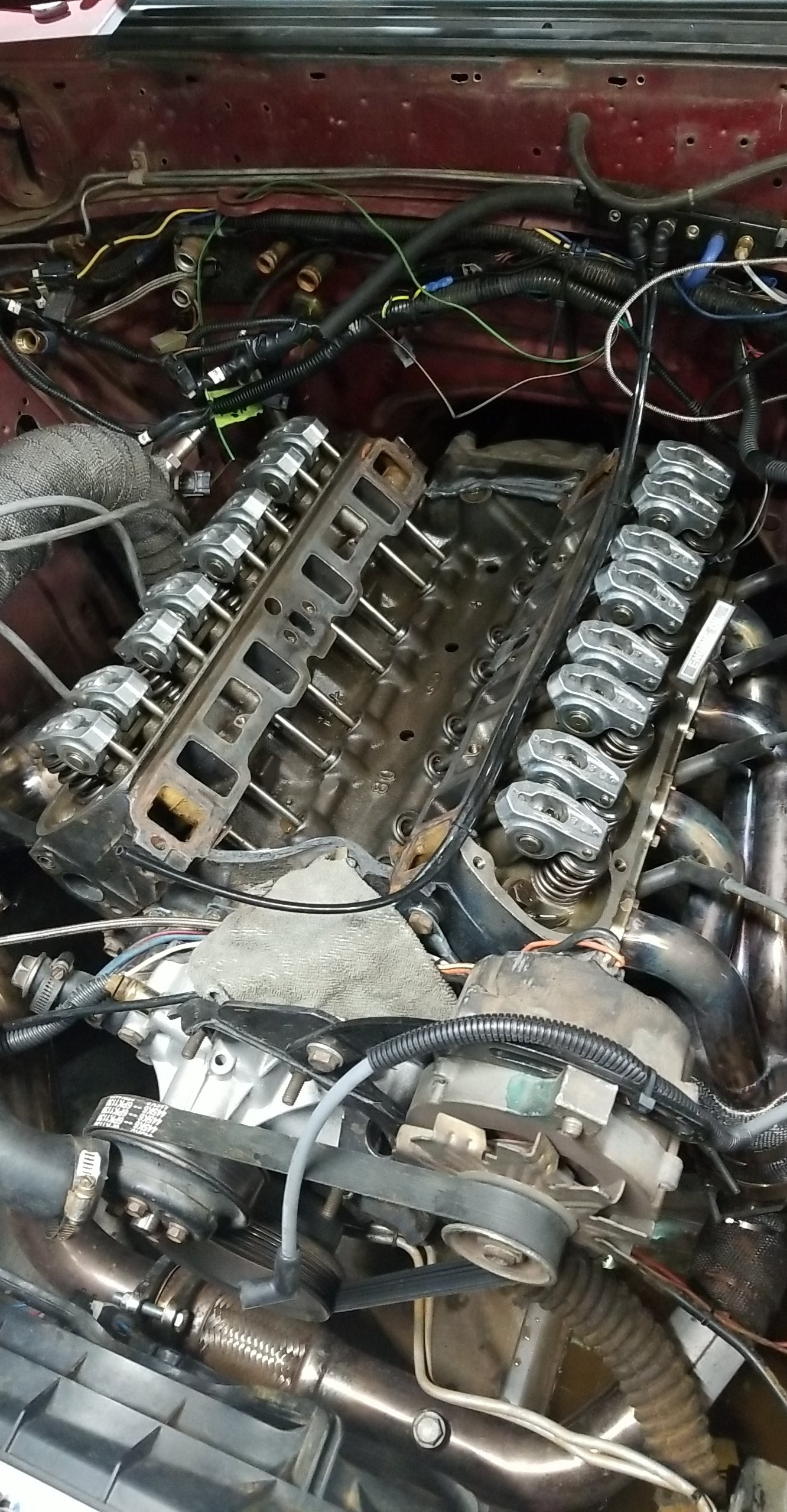

Went up to the shop to start the harness install and ended up with the intake off the engine. Lol. It had to come off to drill the bungs but I wasn't expecting to do it today. Haha.

Underhood wiring is all done. Gaskets are scraped. Bung holes and rail mount holes are marked on the intake. Fuel pressure gauge changed, Fuel line routing is currently being planned.
Gotta come up with a good, repeatable way to drill the bungs. Might have to make something to let me slide it back an forth under the benchtop drill press.Life is short. Be a do'er and not a shoulda done'er.
The bungs are just vertical bosses cast into the intake. I have drilled intakes for weld-in bungs several times. That's no big deal because you then position the bungs and weld/epoxy them in place. This intake needs to be a little more precise since I will be drilling the actual injector mounting hole/surface.
Since the holes will be on the outboard edge of the intake, I have to come up with a way to stabilize/secure the intake so it does not try to dip or lean when applying drill pressure. These holes will only be sealing intake vacuum/pressure so they are not as critical as ones sealing 50 psi of fuel pressure. Nevertheless,I would like them to be done well.
