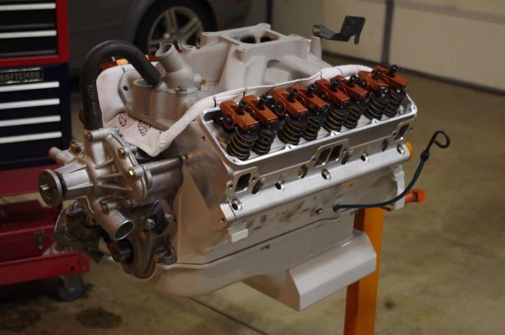

    Originally posted by 91CCFirebird View Post
    Patiently waiting for pics
    Here it is:D
    On it's way to my house is a harmonic balancer install tool, head gaskets, etc... then I can get some more buttoned up
    Also ordered are things like Doug's long-tube headers, and the new Falken tires. My credit card hurts!

        Looks very nice! Is the towel intake gasket a super secret speed part? Are the block and pan painted white?

          Didn't want to scratch the gasket surfaces, I get a bit crazy about stuff like that when I work on engines. The color is a light gray, same as many trans am and can am race engines back in the late 60's, early 70's.

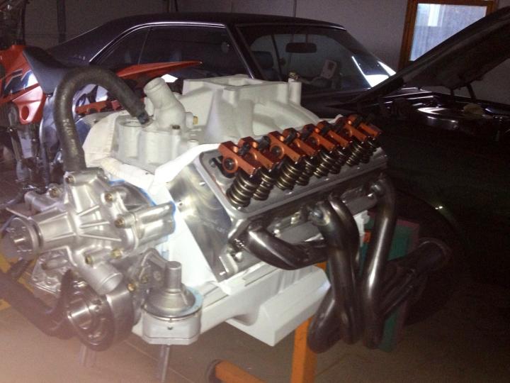

                  A box of tubes showed up today but of course, there is a slight complication, drain plug hits header, ugh
                  Other than that they fit around the engine nicely.

                    Are those Harland Sharp Rockers? I got a set from Summit and sent them back - they looked horrible.
                    I'm really liking the light engine color. Stainless headers?

                      Yes, Harland Sharp rockers, but old ones. These were on the 401 when I bought it so I think they are from the mid-90's.
                      The 401 was in a mud-racing Jeep Grand Cherokee, seller said this motor was on duty for one season, they are in very good condition.
                      My budget isn't enough for stainless :P, Headers are bare steel, I thought there may be a need to cut and move things around. I will be cutting off the 3-bolt flange and replacing it with a ball-flange. Also putting in O2 sensor bungs for dyno work and potential EFI.

                            Easy fix - just leave the drain plug out. Problem solved!
                            Or - You didn't mention what kind of plug was used. If it sticks out at all you could go to a socket head. Our local Parker store has 'em or you could connect with Blulightning (Bob). Now, how you'll change the oil is a different issue.......

                              I just unpacked the headers last night and test-fit them, noticed the interference and went back in the house.
                              Tonight I'll do some fiddling and figure out what to do. Not a big problem, it's a steel pan and I have a welder. The only bad thing is that the pan is screwed tight to the motor with all the seals and gaskets nicely bonded in place. I may need to pull it off the motor, maybe not? Time will tell. I may just plug that drain, and put one on the other side where there is plenty of room between the pan kick-out and the header. Long-tube headers are always a pain somehow.
