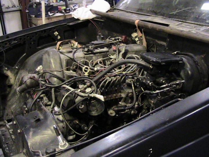

                  Got the engine sitting on it's own feet today. However, somehow I missed one hole for the rubber biscuit - no clue how! So I'll have to weld one up and do it again.
                  Here's the shots:
                  First is the engine in the bay.

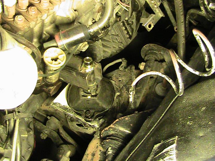

                  Second is passenger side mount in place. I ordered some of those small OD washers for the 5/16 retaining screws because they have to sit in the recess as you can see.
                  Third is the driver's side. That's where I missed the bolt hole (side you can't see).

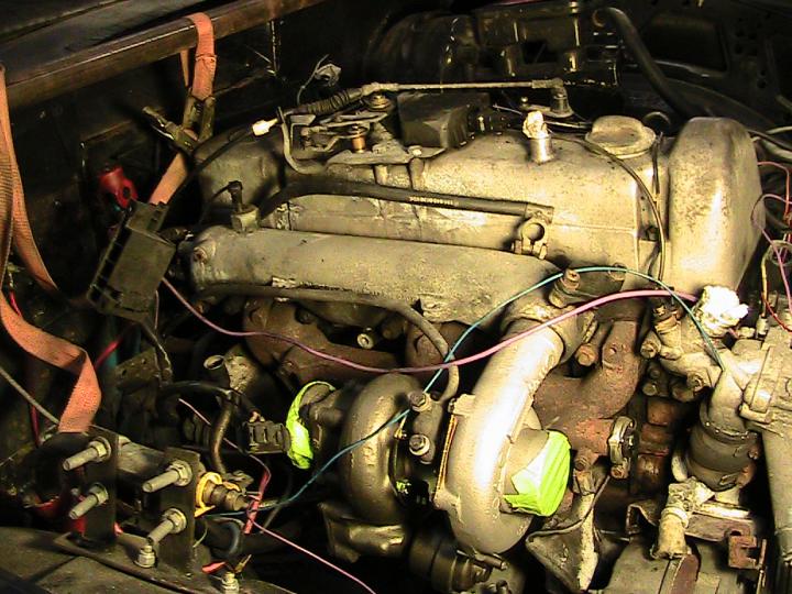

                  Fourth is driver's side overview. The ratchet strap is to hold up the back until I get it up in the air and make something better.
                  Fifth is the passenger's side overview.

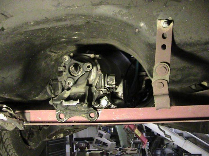

                  Sixth is a look underneath with a temporary brace to hold up the trans. You might be able to see that there seems to be adequate trans tunnel clearance. I might need to massage the tunnel around one of the scattershield mounts but that will be doable.

                      Forgot to mention that I measured everything on the driveshaft/angle, engine angle thing. As best as I can measure it the trans pan is almost level with the rear being about 1* higher. The rear trans mount-to-driveshaft flange (it doesn't use a U-joint there) is about 3* down so evidently the pan and the centerline thru the trans are not the same. The dif is about 4* down (pinion pointing down). All in all, I'm thinking these angles are pretty much OK.
                      Open to input, for sure.
