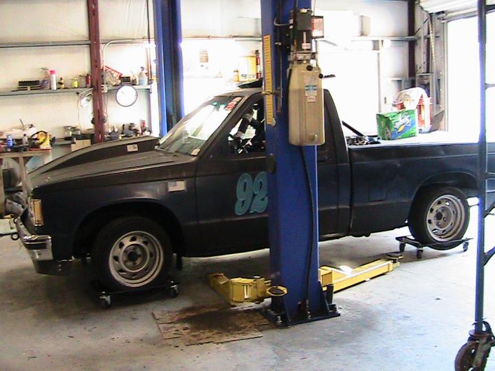

    As promised, it's time to let the cat out of the bag. I was holding back because as a substitute for money I try to boldly go where no man has gone before and find classes that I have a screamin' chance in.

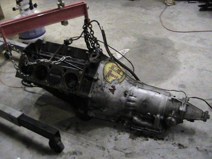

    So here's the deal. My friend Terry (trussell on here) had a S-10 with a blowed-up SCB (in North Carolinian). Seems his cheap LSR engine finally met it's Waterloo. I'd been thinking for some time about the small displacement Diesel truck classes (there are no Diesel car classes) and really wanted to hit one of the not too big and not too small classes. Guys have run the VW Rabbit based PU so there's a higher bar to jump over for those. Anyhow, I found a MB 300SD with a torn up interior and some rust but it ran OK. Not perfect but OK. The trans had all the gears and so I hit on the idea of making the swap.
    Turns out Terry was thinking he could take the old Buzz Bomb Camaro to new heights and I was thinking a F/DT would be pretty cool so we worked out a deal. So following are series of pics - ENJOY!

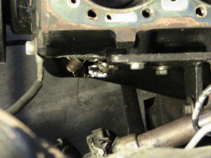

    If you look carefully you'll see one shot of the holey block. I've had fun telling folks that I'm going to scrap a blown SBC!
