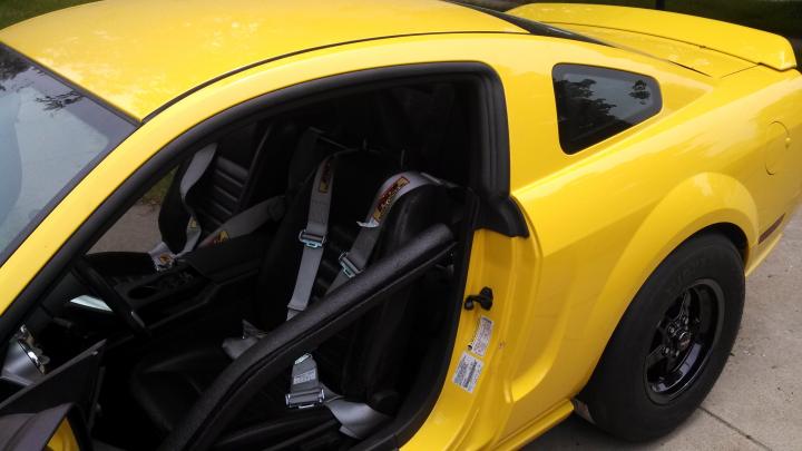

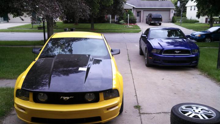

    I have posted almost nothing about my drag week Mustang project that has taken longer and cost more than planned. It is close to ready for drag week. It has a 322 ci big bore stroker 3v mod motor, 4r70w trans with trans brake, a d1sc procharger. Here are some pics. I still need to get subframe conectors welded, lca brackets welded, ARB welded, front end alinment, find trans lock up od trans brake wiring problem and get data for tune revision.
