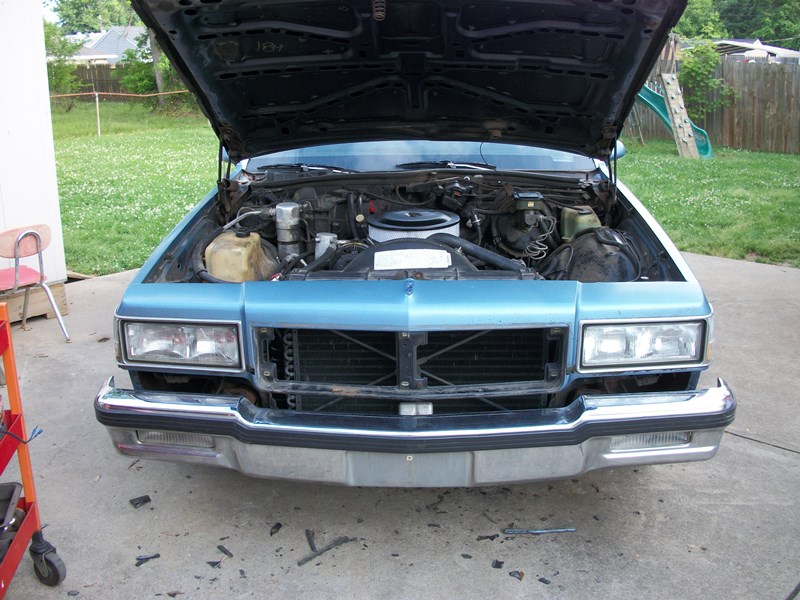

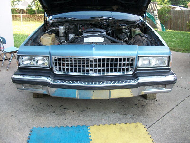

      At this point in the process I'm still debating which carb to run. Basically I didn't feel like going through the tuning process with the AFB, the easiest carb in the world to tune and I'm feeling lazy. I had been accumulating cosmetic parts to replace broken lenses and the bumper filler(s). IF anyone knows where to get the rear bumper filler for a box B-body wagon PLEASE give a guy a clue. My trans guy said I should run an auxiliary cooler too. So while I'm procrastinating on the carb swap I decided to install the headlight, marker lenses, bumper filler, grille, and auxiliary trans cooler.
      I'm not worried about matching colors yet, once the thing is dependable I'll worry about body condition and color.

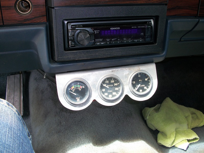

        I had an old but still functional set of Stewart-Warner gauges lying around that needed a place to live and this car having only idiot lights was a perfect candidate, besides, I like to know what's going on under the hood. I just needed a panel to put them in. Enter a piece of scrap aluminum that's been lying around for several years needing a purpose.

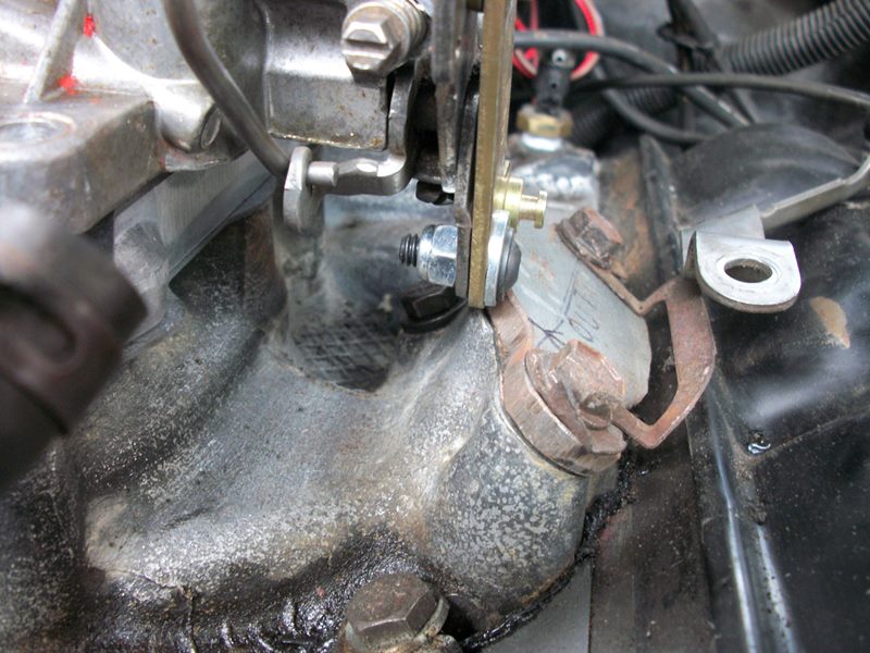

          At this point I've put it off as long as I can, it's time to make a decision on which carb to run. On one hand the Q-Jet is already on the motor, runs pretty good, has the correct tv geometry but without the computer control only delivers 7mpg and tuning parts, while available, are getting harder to come by and I don't have a chart or any means to quickly identify what rods/jets make what changes. It has been over 20 years since I last toyed with a Q-Jet and wasn't very fond of them then. On the other hand there's the simplistic AFB that I have tuning parts for, know how the changes affect the tune, need an adapter to bolt to the spread bore intake, and requires a tv geometry corrector bracket. I decided to go with the AFB since I've had good experiences with them before, it's freshly rebuilt, I have a tuning chart & parts for, and the tv geometry corrector bracket is $25 and I'll eventually have to buy it anyway. The AFB in question is an Edelbrock 600cfm that had suffered some abuse before being listed on eBay for a great price. The total investment in this carb including purchase/shipping costs, cleaning/rebuild, and gaskets is less than half that of a new carb.

            worst factory EGR placement ever LOL
                Agreed. Luck was on my side as the 1" 4-hole spacer was taking space in storage. A friend gave me that spacer years ago and I never put it on anything, I didn't feel/have a need to until this. Glad I had it because I may have put the no-economy Q-Jet back on.

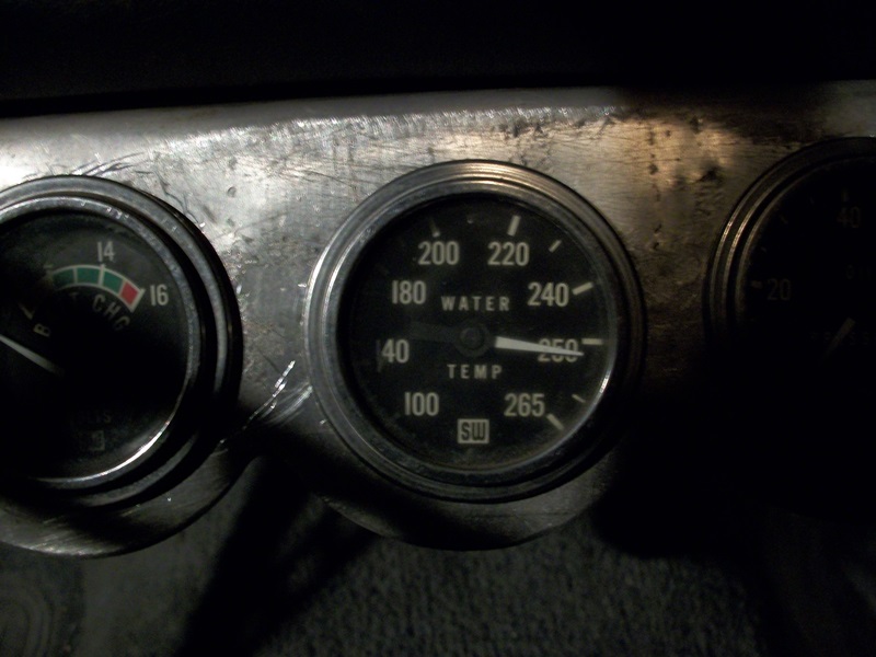

                  SO, after all this work I decide it's time to drive it, get a good feel for the revamped suspension, see if I can tell any performance difference with a carb that's tuned and not running in default mode. After driving for 15+/- miles of steady driving, the oil pressure is in the 10psi neighborhood at a stoplight. Luckily I was about a mile from home. I got it home a shut it off. At this time I didn't notice the temperature. The next morning it started right up and the oil pressure was 45psi. I gave it a day or two before messing with it again. After a couple run-it-in-the-driveway-to-see-what-happens sessions and the oil pressure stays up in the 20psi range when the temperature is at regular operating range. So I figure why not drive it again and see what happens. After about 12 miles the oil pressure is 10ish psi at idle and 15ish psi at road speed (55mph for this particular road). The temperature was climbing slowly but steadily to 240* by the time I got home. Once I shut it off it went over 250*. The radiator cap did its job and the coolant overflow bottle held the heat, it did start softening but held, and the coolant eventually worked its way back into the radiator. I waited until the temp dropped back to 220* and tried to start it. It fired right up but the oil pressure was still 1/3 of what it should have been. The next morning I tried to start it, just to see, and it fired right up and the oil pressure was in the 45psi range. At this point I had/have to consider this motor dead.

                    yeah how is the thermostat? could be it;s just getting stuck

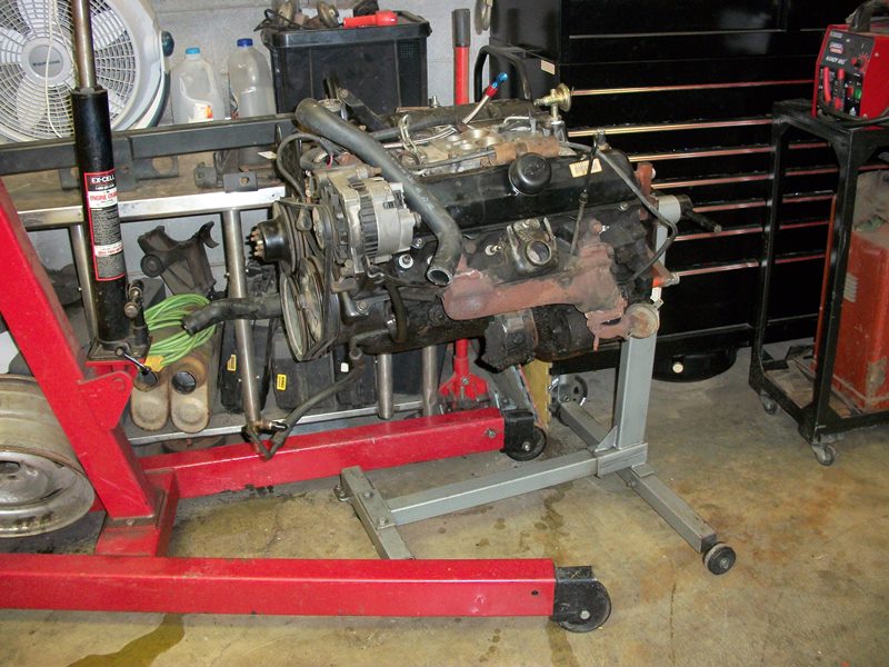

                            Three weeks later the 455 is ready to go in. All I've done to this is change the oil and run it on a stand to make sure it doesn't have any major problems. I did do cold and hot compression tests and a leak-down test. After throwing money at this thing (car) from every angle, for this part I'm going no-budget. If it lasts good, if not I'll worry about it then. I know I said reliable was priority one but between the 3ow7 dying, the 455 going in, and another vehicle unexpectedly joining the immediate family, that makes the role of the wagon not as important as it once was.
                            As of this writing it's just waiting for the carb to be installed.
