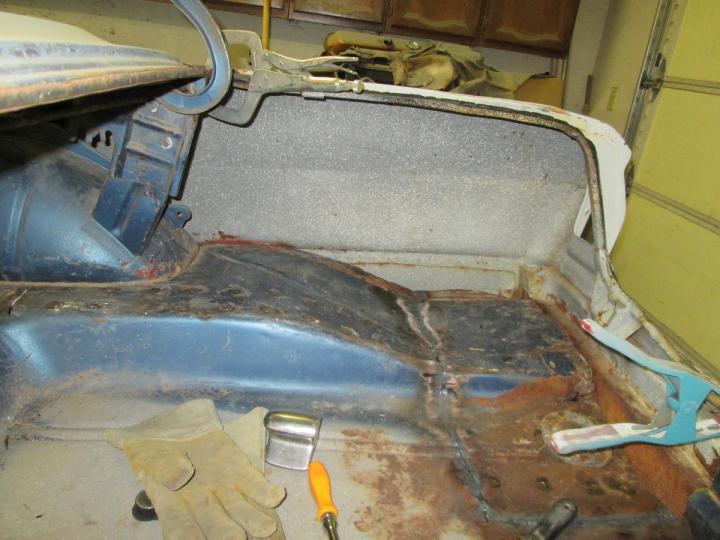

                    #39

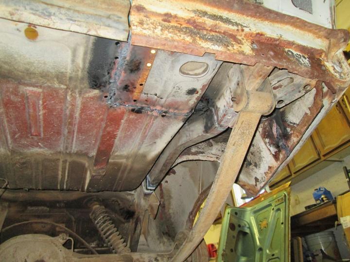

                    Two carbs.... I got some work done on the rear corner of the body, but there's a lot more to do. I welded the trunk corner back in, and put the shackle back in and put some weight on it. I spent some time cleaning up the quarter panel, took out the remains of the old inner wheelwell. I have more fitting to do, and I need to extend the trunk corner back a little where it was cut off. I need to put the B pillar back together also. And the bottom of the C pillar is a mess.

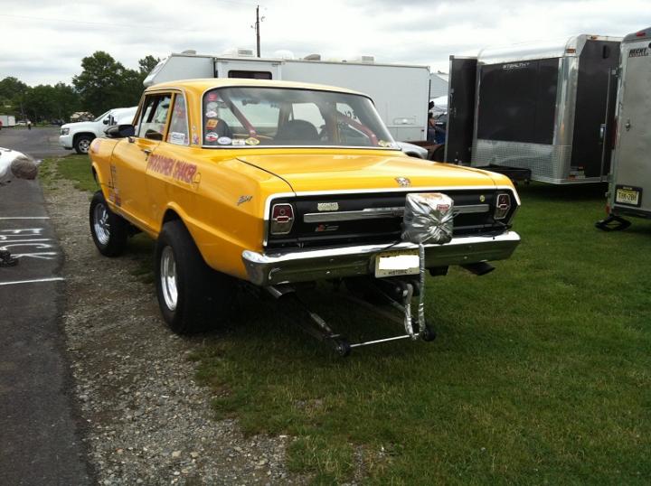

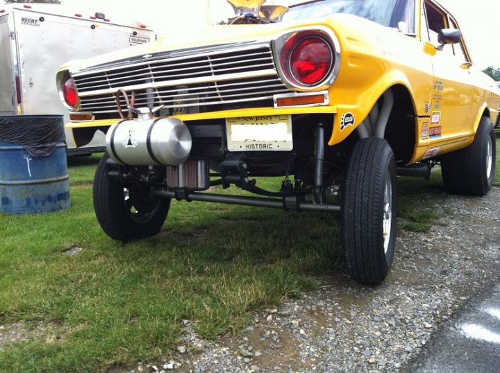

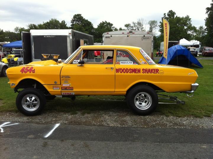

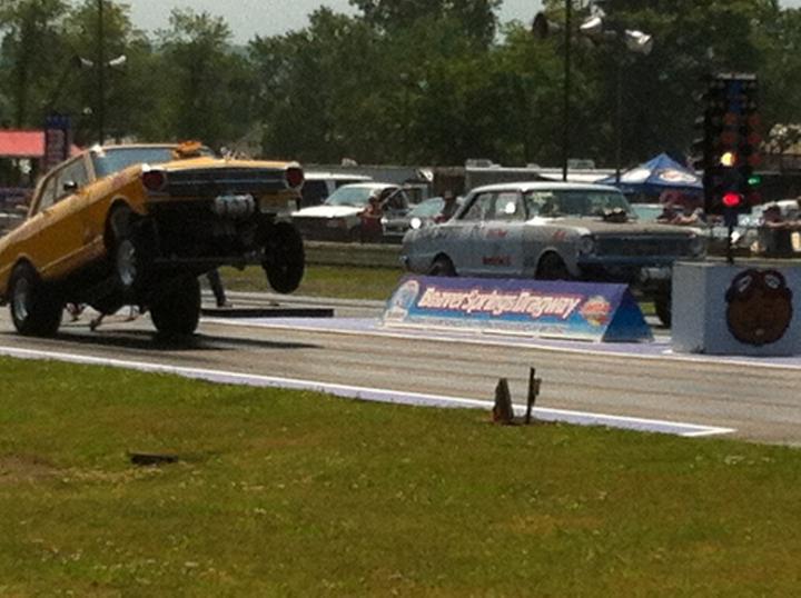

                      #40

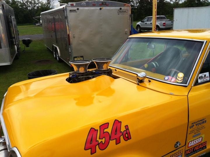

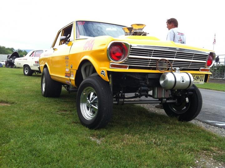

                      Damn you're working fast Squirrel, gonna be a cool project. Here are some pix of one that I took earlier this year at the Beaver Springs PA Gasser Nats. You can see in the last shot that he was workin it!
                      Rich

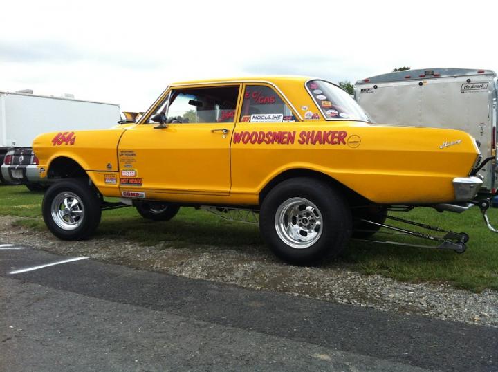

                        #41
                        Saw this today, thought I would add to the pics
                        Drew Gerth - Newburgh, IN

                          Got to love those chevys with the ford thunderbolt hood scoops! You make this stuff look way easier than it is......

                            thanks for the pics! The yellow car has a lot of the build ideas I'm planning...interesting....
                            Do you know what's under the hood?

                              #44
                              Had a thunderbolt hood on a 77 Chevy truck at the same place.....don't get it myself

                                At the risk of sounding like either a smart or dumb @$$ I would say a dual quad 454.
