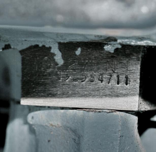

    Anyone wanna guess on this package.

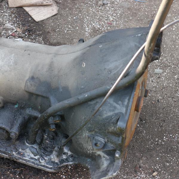

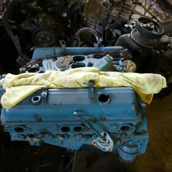

    I just traded for an engine and tranny to put in the 66 Impala so I could make a driver out of it and get it down the road. They are not sure what it came out of, but think it might have been a 78-79 El Camino with a th200 4r. I can't quite make out the numbers and won't get a chance for a few days to get up where its at right now. Probably a 305...
    Anyone have any insight. There is a quadrajet and HEI (not in the pics) and a flex plate that will come with it.
    I tried adjusting contrast and cropping to bring up the numbers, but can't quite make them out. Hoping someone is familiar with the EL Camino's and might recognize them.

    Need to see a pic of the trany pan... Also on the back of the block on top of where the trany bolts bolt in there will be a cast in casting number with 8 digits, that is the block casting number, get a pic of that then we can tell you what it is.......

      If I remeber right the drivers side rear of the block will have 5.0 if its a 305. 5.7 if its a 350.

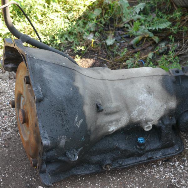

          On the transmission, didn't 200's come with BOP and Chevy bolt patterns? That one looks like a Chevy only, may be
          a 700. The pan is a the easy way to tell.

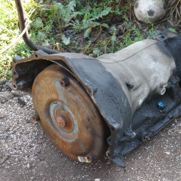

            These are the only other pics I have of tranny. I will just have to wait till I can get out there I guess. The engine and tranny were pulled so owner could put a 383 in there and a new tranny. He basically doesn't know much, just having everything done by others to get it done. I traded him a set of old Bose speakers and the amp that went with them, because I haven't used them in years.

              The four pin plug on the left, makes me think it's a 700.

                The transmission is a TH350C (lock up TH350). That's why it looks just like a TH350, but it has that four pin electric connector for the converter lockup wiring. That's what I would expect behind a 1979 vintage engine.
                19Lxxxxxxx means it's from a 1979 chevrolet car assembled at the Los Angeles plant.
                xxxxxDNH the engine is a 305, but this suffix code says it's a 2bbl engine from a Camaro.
                  Thanks. Makes perfect sense from what the owner thought, but wasn't sure. He is a hard core Pontiac guy and noot sure about history of the El Camino.

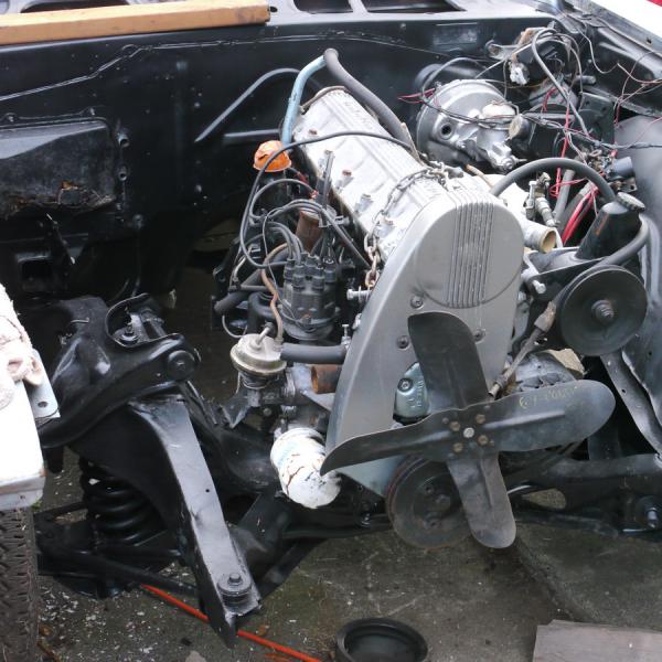

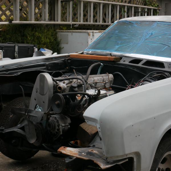

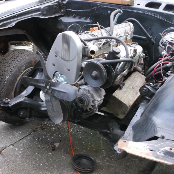

                              I still have some other options too if I can find some frame mounts for the OHC-6. It seems to fit just fine if I just tweek the oil breather pipe a bit.
