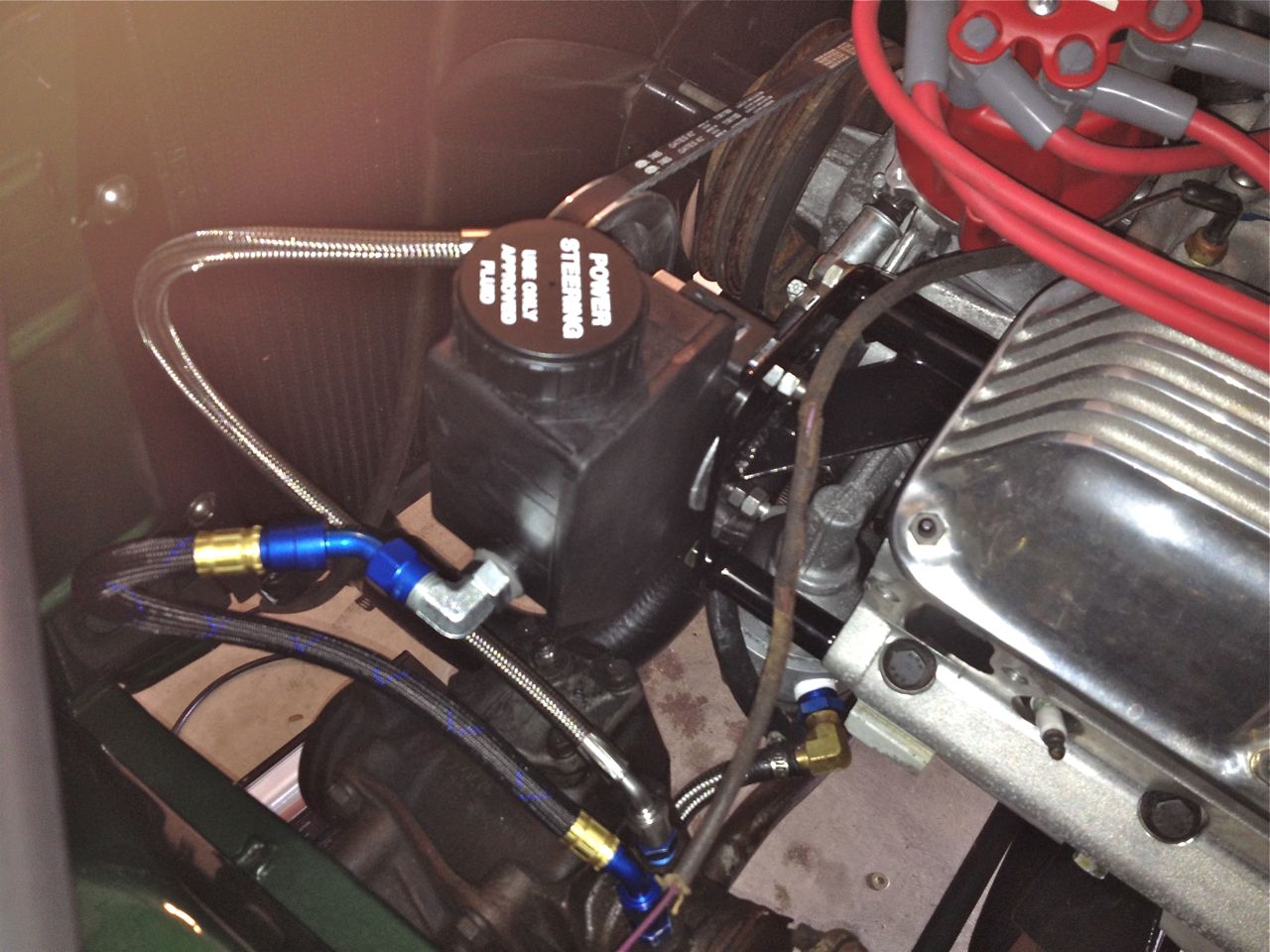

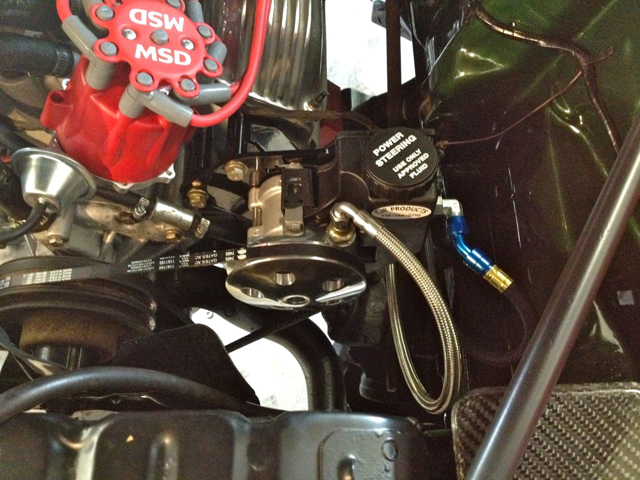

    - Old power steering pump off, new bracket on for a test fit. all looks good, pump arrives tomorrow. I'll need to install the pulley and test fit it, then figure out where to get AN, high pressure power steering lines. If anyone knows where I can get them made please let me know.

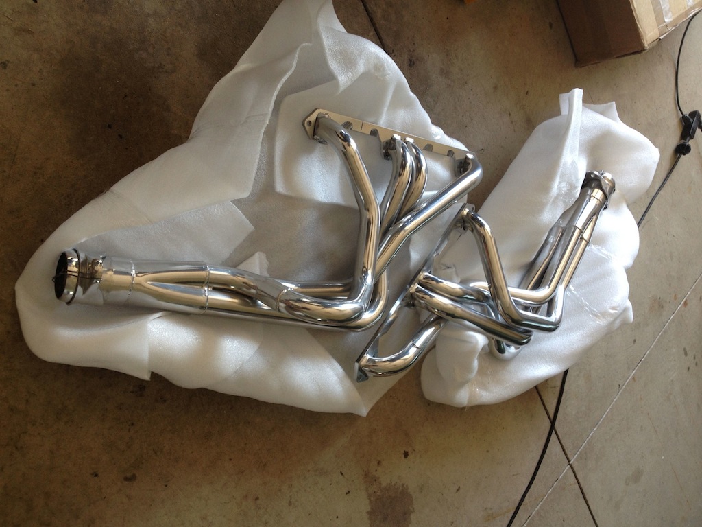

    - Headers off ready to send to Jet-Hot. What a huge PITA! I completely under estimated that effort. had to remove z-bar, dipstick tube, starter wires, starter heat blanket, and then weld one of the header seems where two of the pipes meet. Today at work I need to find a big-azz box to fit the headers in, or pay a packing company to do it for me.

          Headers on the way to Jet-hot, supporting a sponsor, I like the lifetime warranty idea. should have it back in about 2 weeks.

            OK, New CJR TC/Type2 Power Steering pump is on, fits great on the new bracket. I need to press on the pulley and line it all up. Today I ordered custom power steering lines from Brown & Miller racing. those arrive later this week, and I should be able to button up this little amazingly expensive power steering project.

                  Power steering lines arrived today, test fit OK!, now I'll go out and button it up.
                  In the top picture, notice the contrast between the new aluminum pulley, and the water pump pulley that was junk yard fresh last year this time. I kinda like it.

                    Time to get to work and get it all back together!
                    From a visual standpoint, Jet-Hot did a great job both inside and out!
