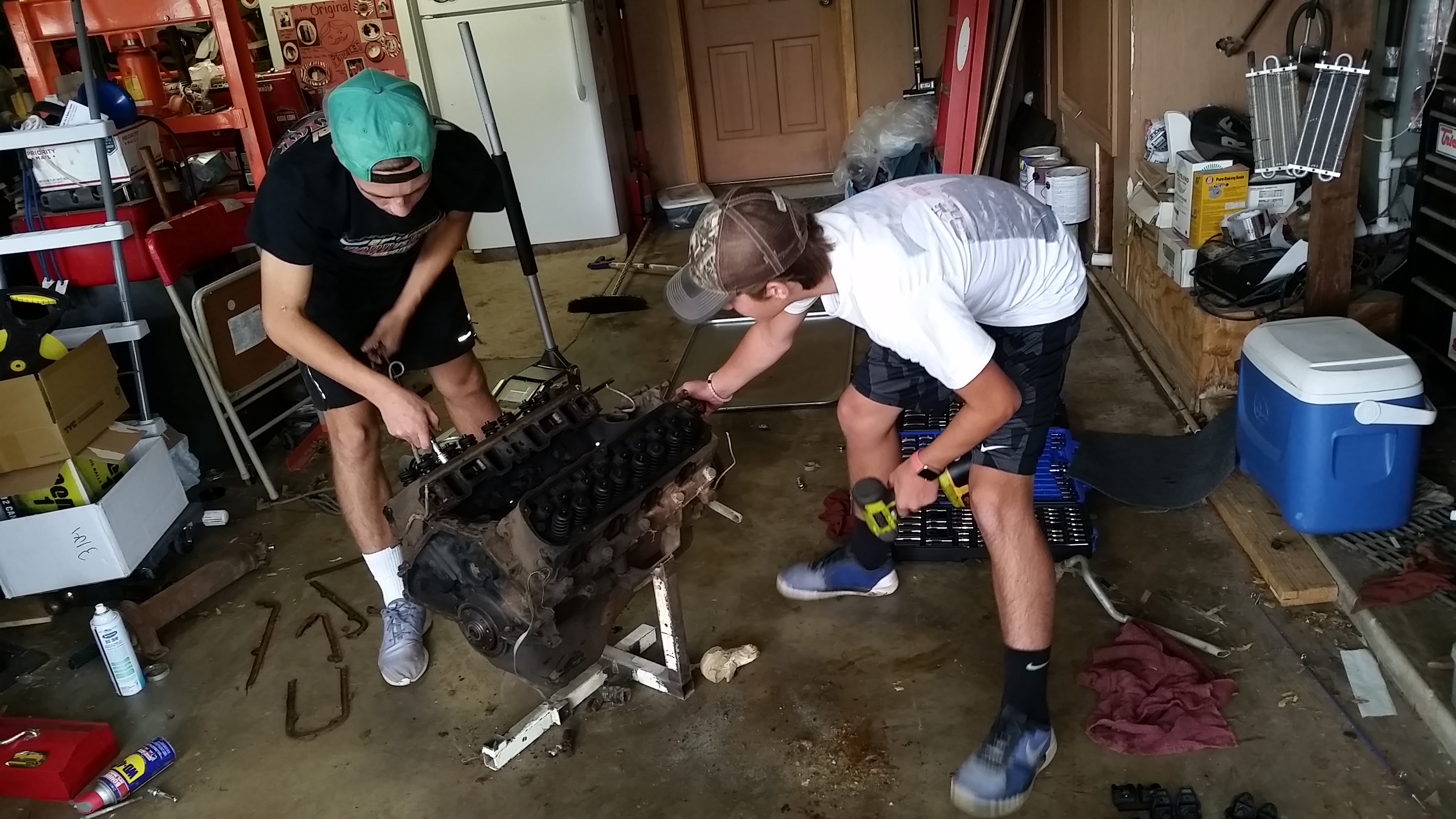

Nope. Most likely this one! The original 302 from this car. Provided is is not thrashed when we do some internal inspection.Originally posted by Beagle View Postby small block, you mean at least 408" right? (don't tell mom)
A stockish 302 with a 150 shot of N2O will be more than enough entertainment for him.Life is short. Be a do'er and not a shoulda done'er.

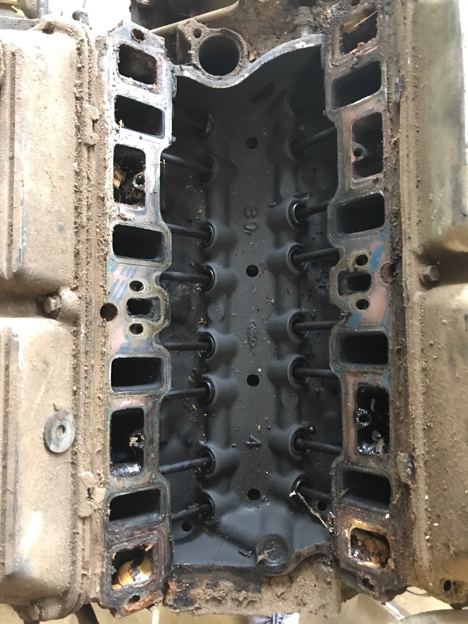

Not terribly bad.

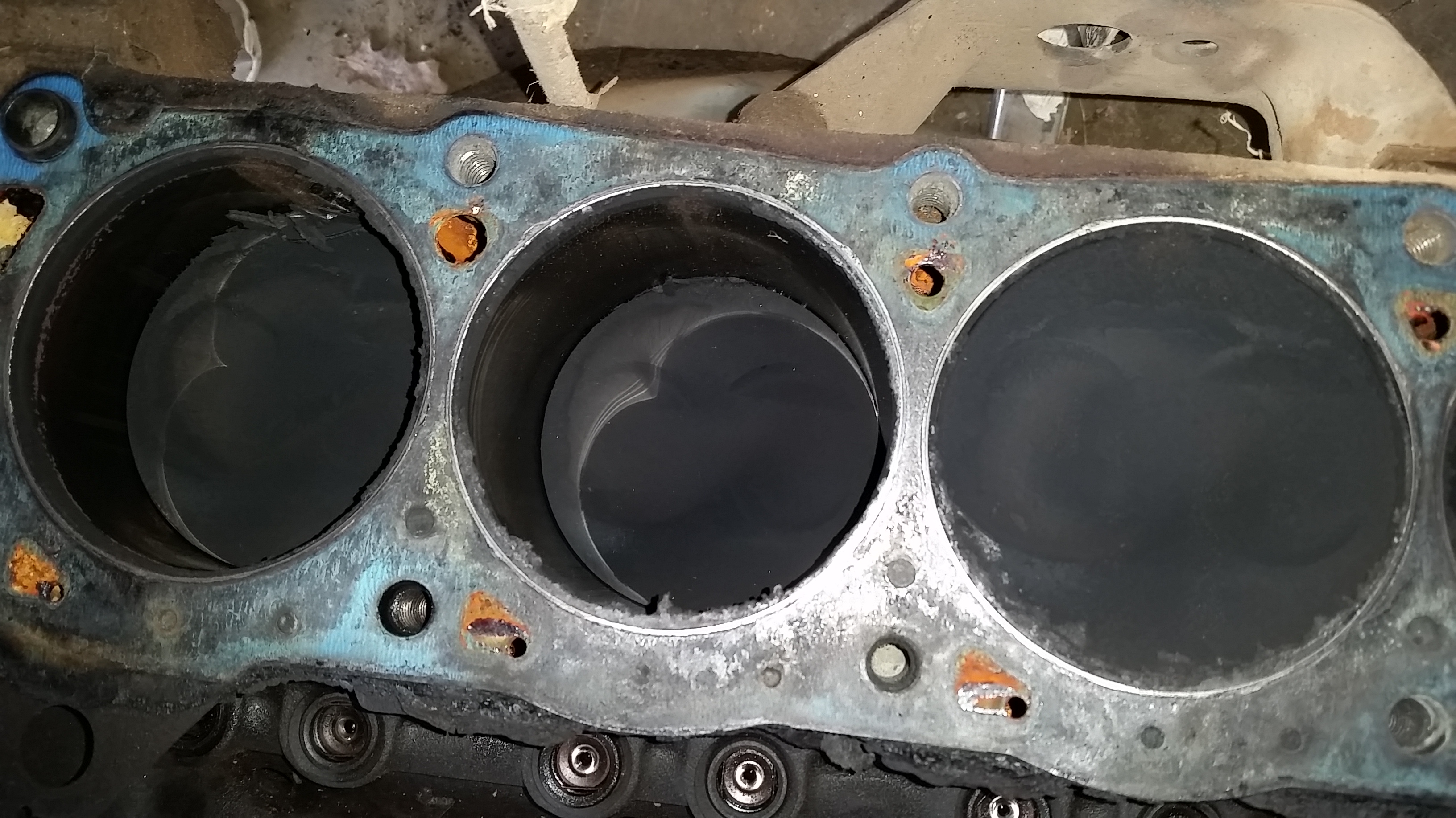

Massive amounts of carbon!!
Engine has been apart at some point. Felpro gaskets. Very minimal ring ridge, cylinder walls actually look pretty good. Good enough we will hit them with a hone and call it good. Have not checked bore diameter, but I think it is stock.

I was really impressed that there is no evidence of water getting in it and the fact there was not a rat nest inside it!

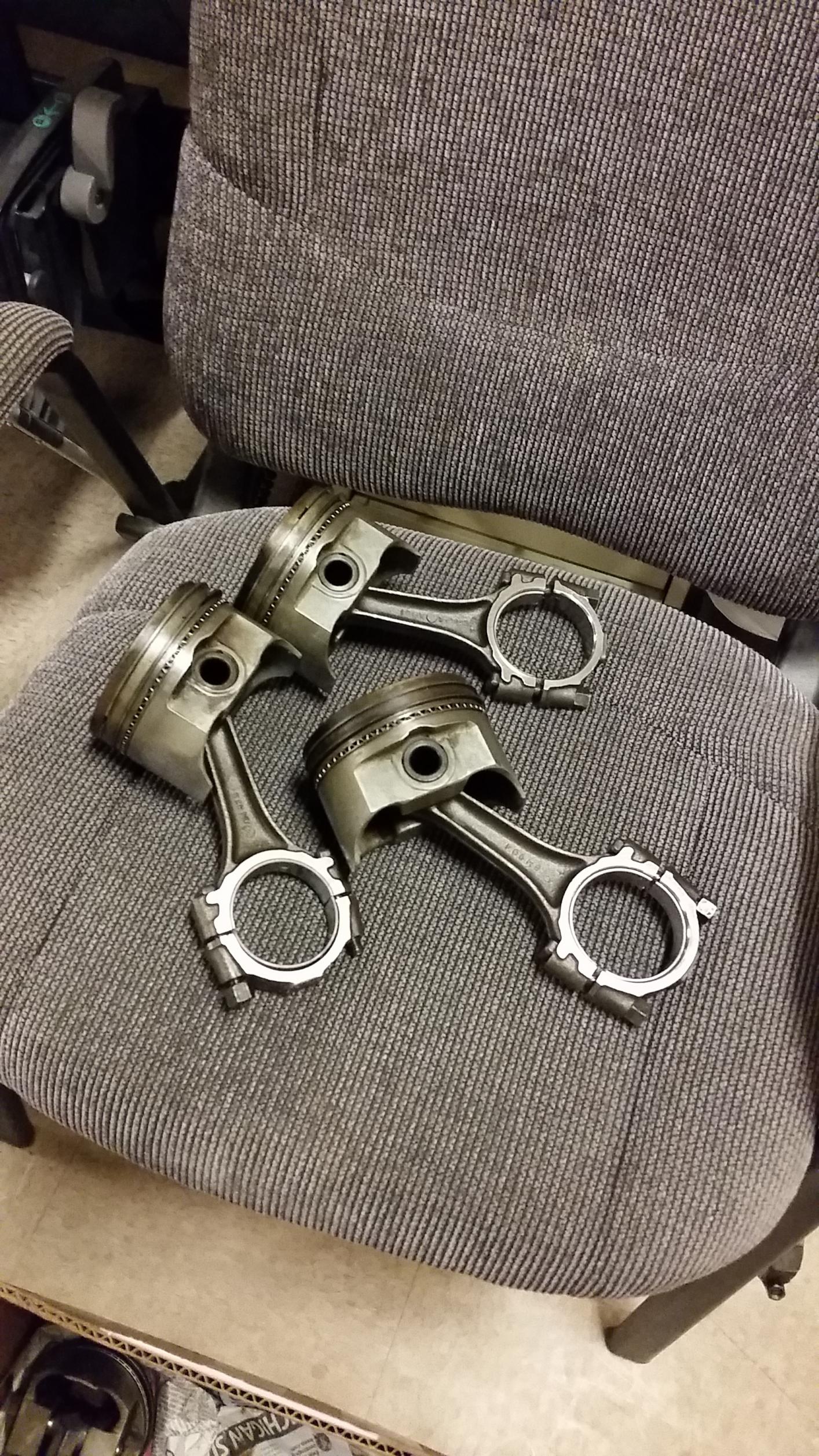

This thing needs compression like crazy. The 70's heads have 58-ish cc chambers. Stock CR is an abysmal 8.3:1. I just nabbed a set of used stock 87-92 forged pistons w con rods, so they will help some. These stock heads are rumored to be in the 69cc range. Gak!!Life is short. Be a do'er and not a shoulda done'er.
We have pistons! They look pretty decent. TRW E7ZE's FTW!
