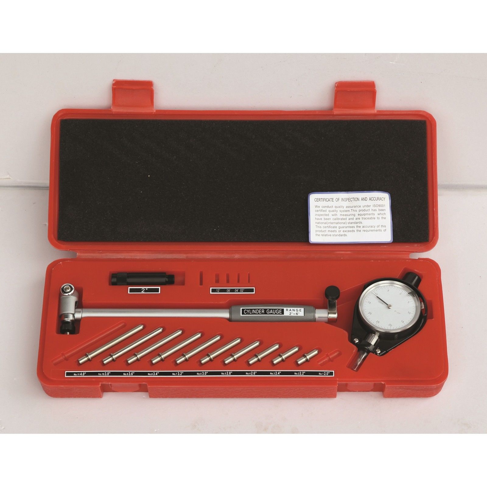

Not HF/Northern Tool, but not far from them! It was 62 dollars or so on ebay. Not too expensive and soooooooooooooo much easier than snap gauges.Life is short. Be a do'er and not a shoulda done'er.
I have the same one - but it came in a black plastic case - LOVE it - as Dan says I use it for the cylinder bores, and to check all the bearing journal diameters. I got a set of 0-6" mechanical digital micrometers - so bearing clearance is easy, measure shaft OD, bearing ID and subtract - no more plastigage!There's always something new to learn.Comment
Zero the bore gauge in the mic, and read clearance directlyMy fabulous web page
