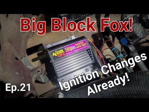

    I 100% have the magnetic pickup wired backwards.
    I was confused yesterday because everything is set up right and it was kinda acting weird. It would act like it wanted to start when cranking, but just wouldn't light off.
    That sent me down the path this morning to verify stuff was wired correctly. Then I noticed it.
    The Accel's wiring:
    PURPLE (+)
    ORANGE (-)
    Duraspark distributor wiring:
    PURPLE (-)
    ORANGE (+)
    I verified this using the MSD 6AL instructions. It also has the MSD purple (+) wire attaching to the Ford orange wire (+) and their green wire (-) connecting to the Ford purple wire (-).
    So today i am going to swap the wires around and see if that improves things.

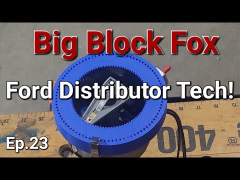

    Distributor tech and a look at the tool I made with my 3d printer.

    I did design a new tool to measure the mechanical advance of distributor. It clips onto the top of a distributor in place of the cap with degree marks. You just hold the shaft solid and cycle the rotor and measure the movement in degrees. Double that number and you have crank degrees of advance.
    Pics please!

    I bench tested the distributor and prove that I'm not going crazy. Then I do the logical thing and begin installing a completely different ignition system.
    Not sure that testing the distributor proves that you're not going crazy (hey, we're both doing this car stuff which is not the sign of a healthy mind) but I'm thinking a different ignition seems like a good move.

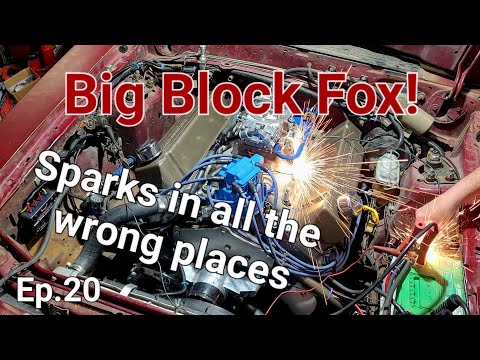

    Found some sparks.
    I set up the current distributor on the bench and nothing.
    Did the same with another HEI that Judd got with the Galaxie. Zappo. It worked perfectly.
    Poked it in the car and...... Nothing.
    Just for tickles I ran the distributor power directly to the battery. Hit the crank button and it tried to start!
    Whoo hoo!
    My only guess is it has something to do with how I have battery power routed in the car. Currently the (+) cable goes to the starter and then up to the original relay on the fender where everything else also ties in for power. Seemed like a good idea, but I guess the starter sucks enough that either the ignition does not have sufficient voltage or the ignition relay does not have sufficient voltage to stay energized amd cuts off.
    Next I will reroute power to the relay module so that it is directly connected to the battery.
    I will probably still change the ignition up like I was planning but right now I'm just super happy I found some sparks.
