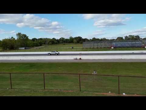

      Here is the video of me in the finals. The Buick I got paired with is a friend of ours and his car was not doing well. This pass was a 12.23 @ 115. I didn't warm the bottle as much and really not sure past there.

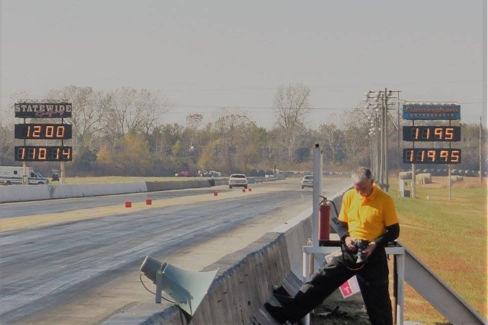

            [ATTACH=CONFIG]n1127637[/ATTACH] Some cool pics by the track photographer.

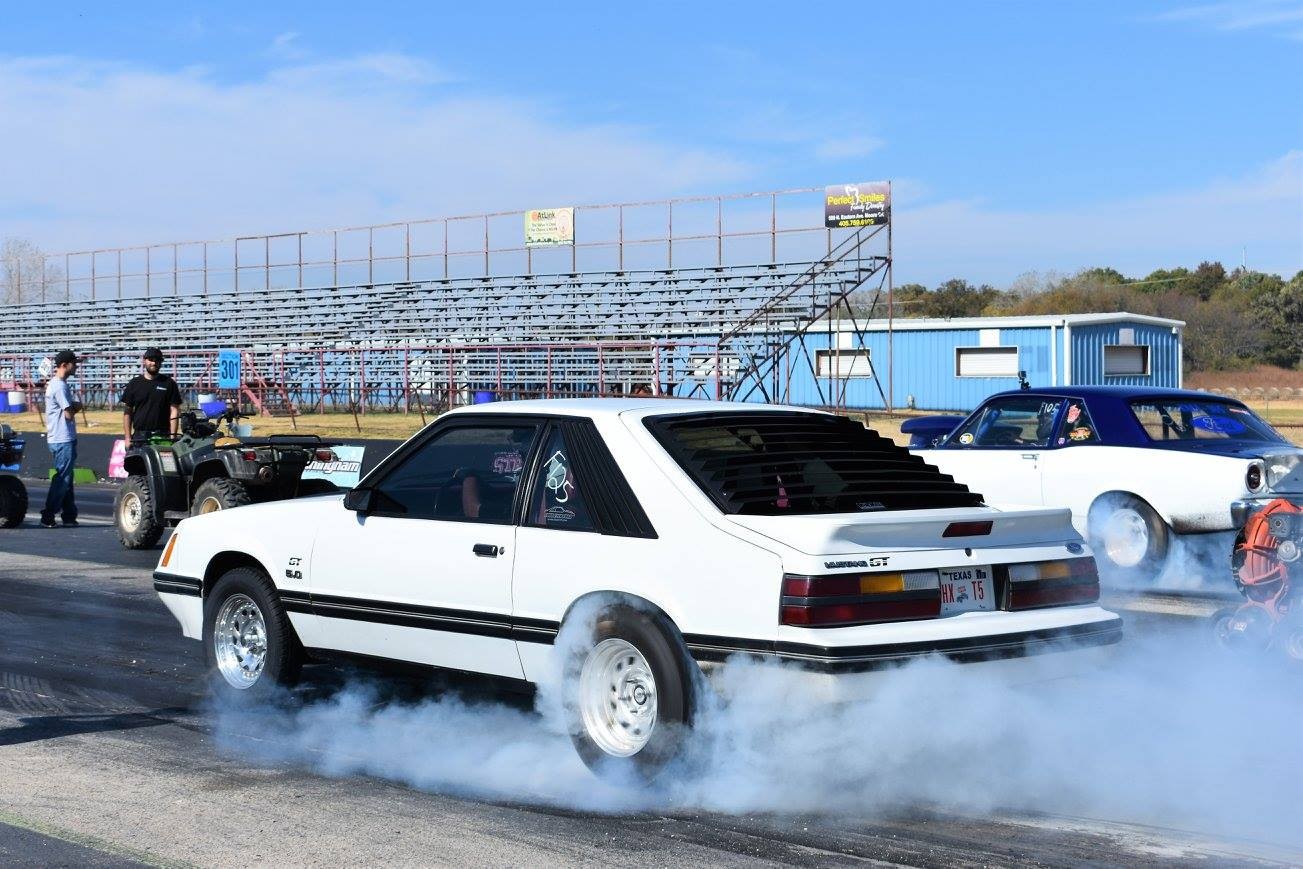

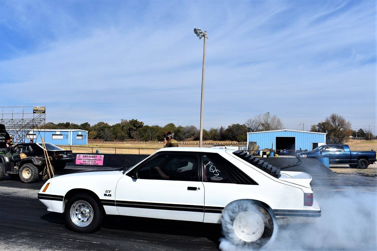

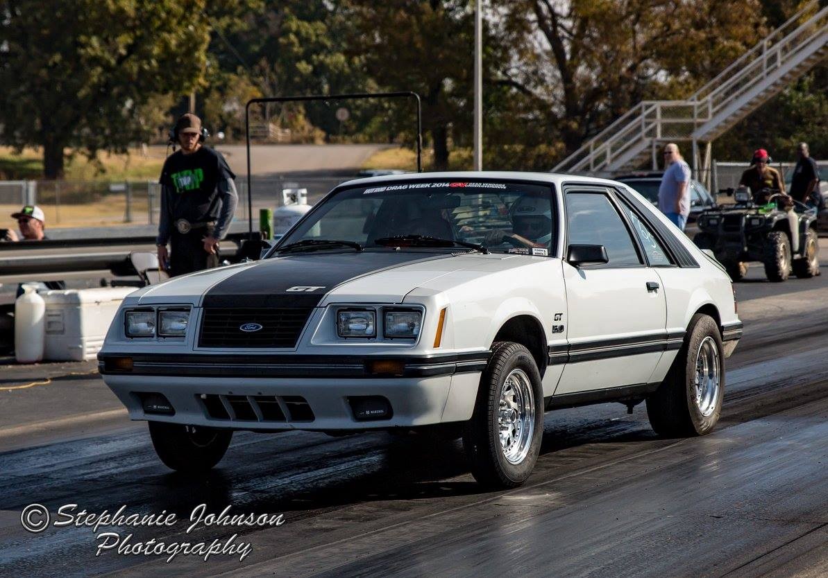

                            Here are a few pics from the event. burnout

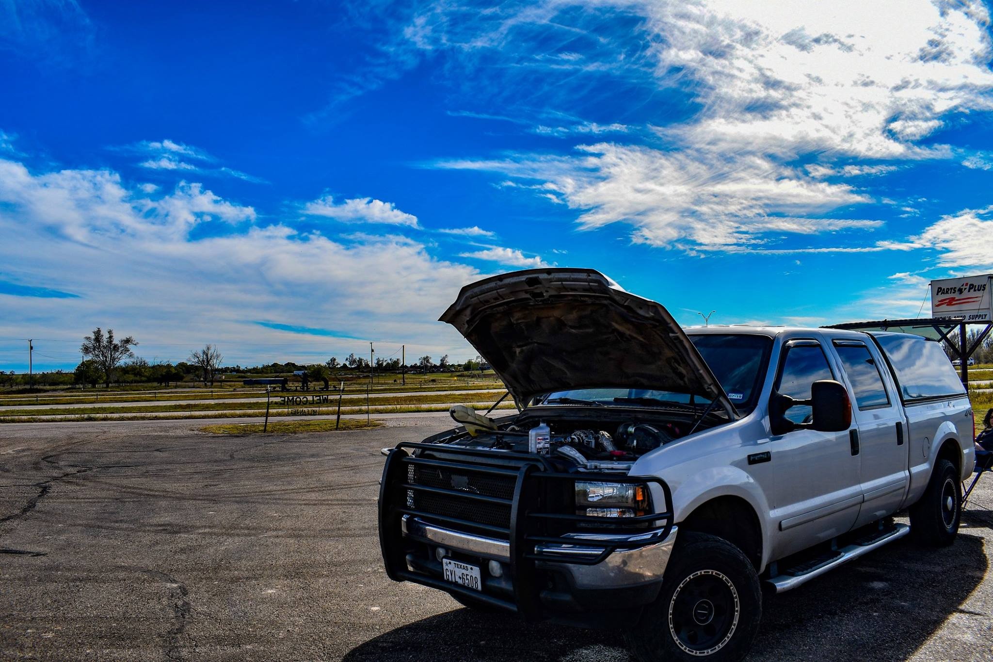

                                We left on friday about noon to try to get there kinda early, the truck decided to have other plans. One of the belt tensioners locked up and killed the belt. We were about an hour outside of amarillo and had to wait for one of our friends that were behind us to grab the parts and bring them to us.
Name:
                                After parts were there it was a 10 minute fix, bad part about it we were sitting in front of a closed parts store. The owners were at a wedding in Marfa (about 8 hours south).

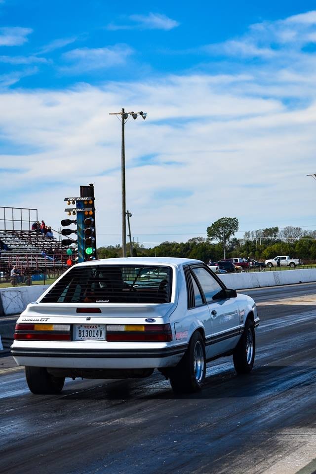

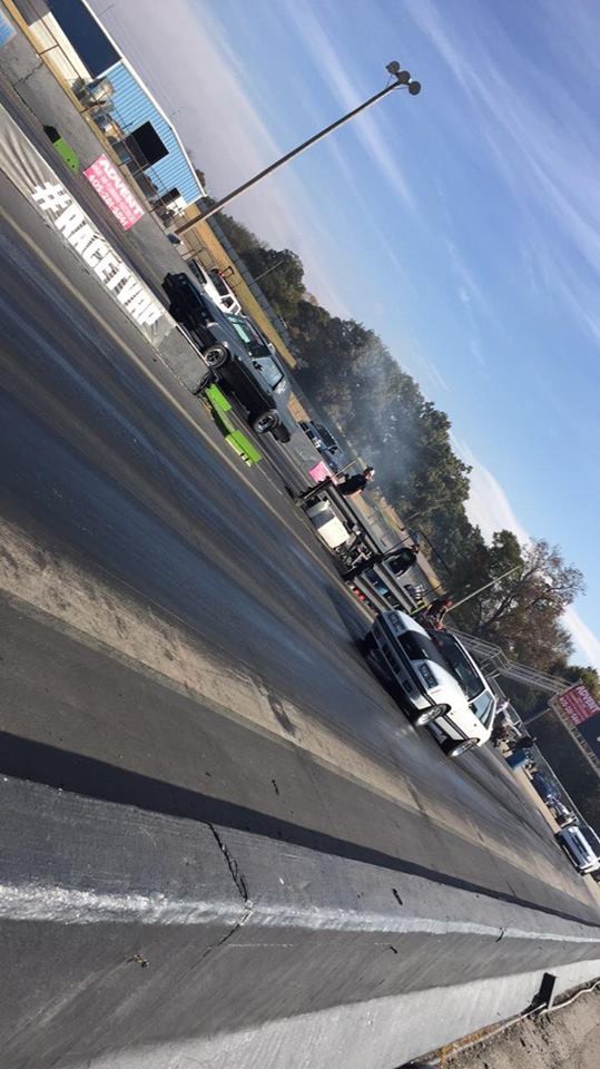

                                This is the fastest pass of the day. We felt like got it sorted and went to the 200 shot later and the car spun all over the track. Quite a scary ride

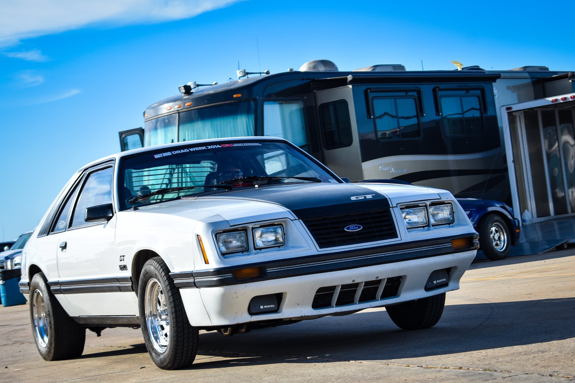

                                My wife did a great job of shooting the event. Here are some pics of the car
                                Click image for larger version  Name:	 Views:	1 Size:	109.3 KB ID:	1219234
                                Click image for larger version  Name:	 Views:	2 Size:	195.4 KB ID:	1219237
