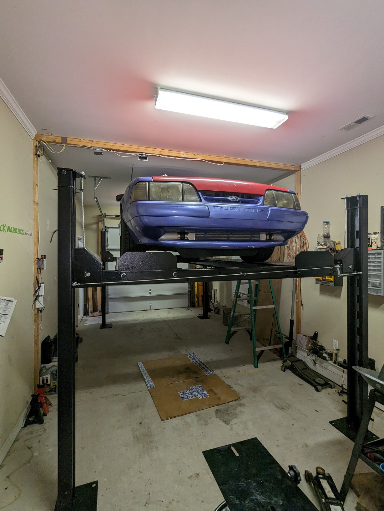

                            I am not good at welding on my back. I don't feel like pulling the entire hot side, I need to pull the transmission out of the Camaro. Not much to update on the car, but I did get a new tool! Does my shop makes it look big?

                              I'm jelly! That's the kind of lift I would like to have!

                                2 questions,
                                What is your ceiling clearance height including clearing the door, opener, door tracks?
                                And what is the working clearance underneath it as pictured?
                                OK, 3 questions,
                                Who is the supplier and if you want to divulge the price delivered?
                                Looks like a Very Nice, Old Guy Knees and Back Saver !!
