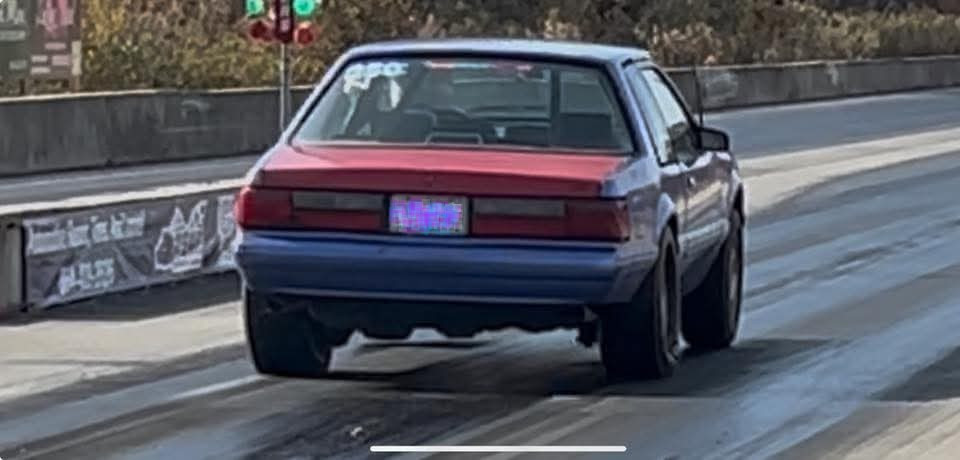

  • Russell
    replied
    Street and Yeet 2025 is in the books. I was able to improve my average a little over my last SNY (2023). D1 7.31, D2 I got a new PB 1.43 / 7.20! It appears it even got a sliver of daylight under the tire! D3 first pass I forgot to turn on the boost controller and ran an 8.04 on gate. Second pass it spun, I had had enough of Carolina and decided to hit the road. D4 7.29. I had hoped to run in the low 7's all week. Stretch goal is to run a 6.99 with the stock 5.0/T5 been reviewing logs I think it's time to add compressed air for boost control!
