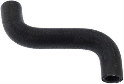

                              slight set back. the hose i have is not stiff enough and kept colapsing when i tryed to bend it at a 90* soooo i then had to get creative. i have now foudn a use for a 1978 dodge colt with a mitsubishi 2.6L 4cyl (scary i know)
                              it's outlet heater hose is premolded in this shape and fits perfectly around the intake witha hose splice i can connetc the other rubber hose and every thing wll still be accessable with out removing the intake incase of future leaks
                              all in all this will only cost me $16 totals versus the $100 i would of had to spend on the metal hose and water pump outlet

                                #75
                                progress
                                here is that heater hose form the doge colt vista
                                and it looks like an engine
