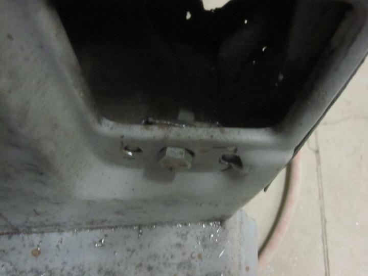

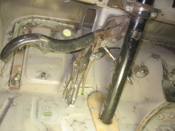

    Anyways, here are some things I've been doing on it recently. I had to fix the captive nuts for two of the door hinges, so I made a couple new plates to hold them and welded them on from the outside. I have to deal with the parking brake linkage, originally it was on the frame where the upper control arm is now, so I got a flexible cable from a later truck and I'm modifying the bracket to hold it by adding a piece from a 64 chevy truck. I'm also doing bodywork inside the truck, adding bondo to the widened wheel tubs, and fixing a few other areas that need to be filled. I'm going to see if I can get the inside primed this week, and start on the doors. I also need to put an engine together, since I swiped the 454 out of this truck to get the other 57 truck going. I have most of the parts to put another 454 together, but I need to get a pair of heads done. I'll probably use a pair of 70s oval port heads, and swipe the valves and stuff out of the peanut port heads off the 454 I was originally going to use in the other truck. I have the block bored and ready to go, rods and used .030 over pistons are ready, I have a reground crank, rings, timing set, and some other parts. I guess I need to order some stuff from Summit too.

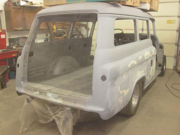

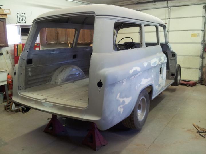

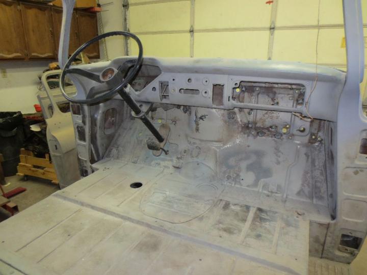

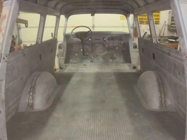

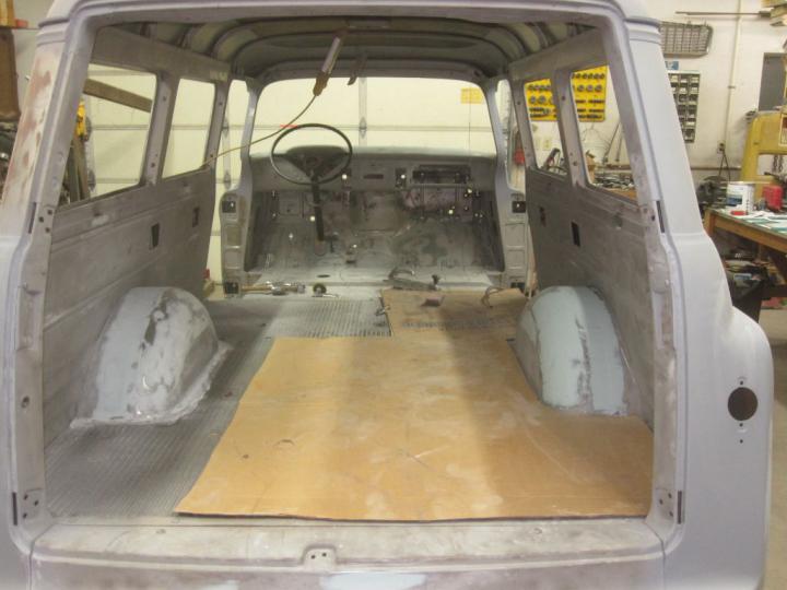

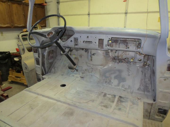

                        The 4x4 suburbans are neat trucks, I built a 64 for a friend about 10 years ago. I thought about making mine into a 4x, but I've had a few 4x4s over the years, and never really use them. Anyways....I got a little bit done today. I really don't like doing bodywork. or paint. I fixed a few things on the lower door hinge pockets, including welding the fender mount back on, it was hanging by one spot weld when I took the truck apart. That whole side of the firewall/cowl/dash wasn't spot welded very well, it's like the guy doing it couldn't keep up or didn't know what he was doing. Interesting thing is my other 57 truck was made right before this one, like less than 300 serial numbers apart, and it has similar problems on that side, but not as bad. work on the wheel tubs is progressing. There's a LOT of sanding still to do on this thing, the interior is like painting the whole outside of a normal car. the outside of this thing is huge, like the outside of two or three normal cars.

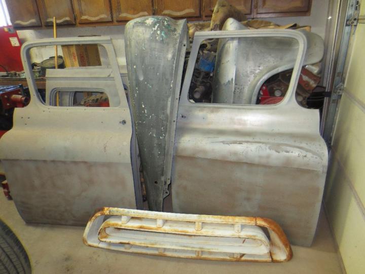

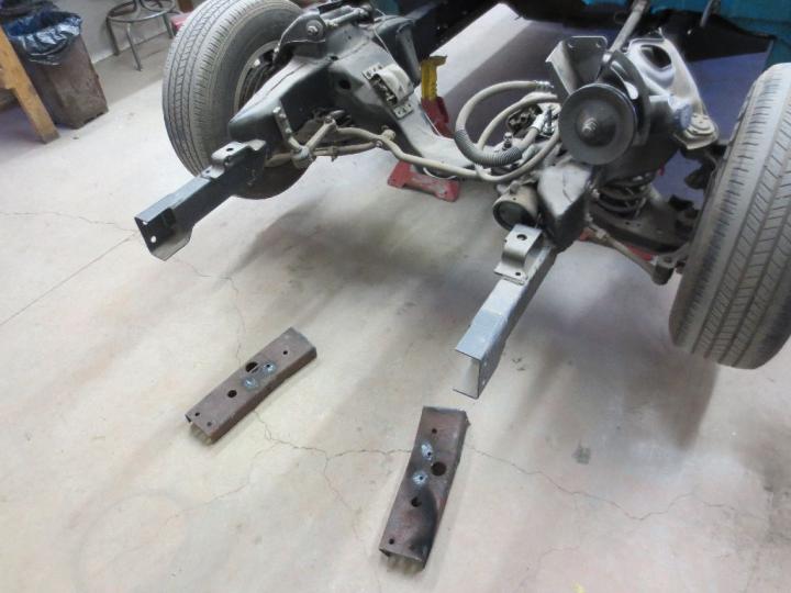

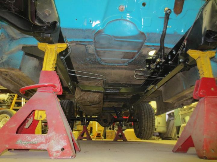

                              A few pictures....I'm getting ready to work on the front sheet metal, first I need to fix the slightly out of position frame horns, then finish sandblasting and sanding body parts and put some primer on them. I also need to prime the doors and hinges, and put them on.
