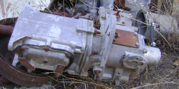

    Look at this:
    That's a Muncie welded into a Toyota case, for desert racing. Not what you'd want, and too bad the weather's gotten to it, I picked it up 'way back for something I didn't wind up using it for. I'm not sure how bulletproof that t-case is anyhow, there's some pretty small-diameter stuff in there...if you were gonna hold out for something tougher that could be a good thing.
