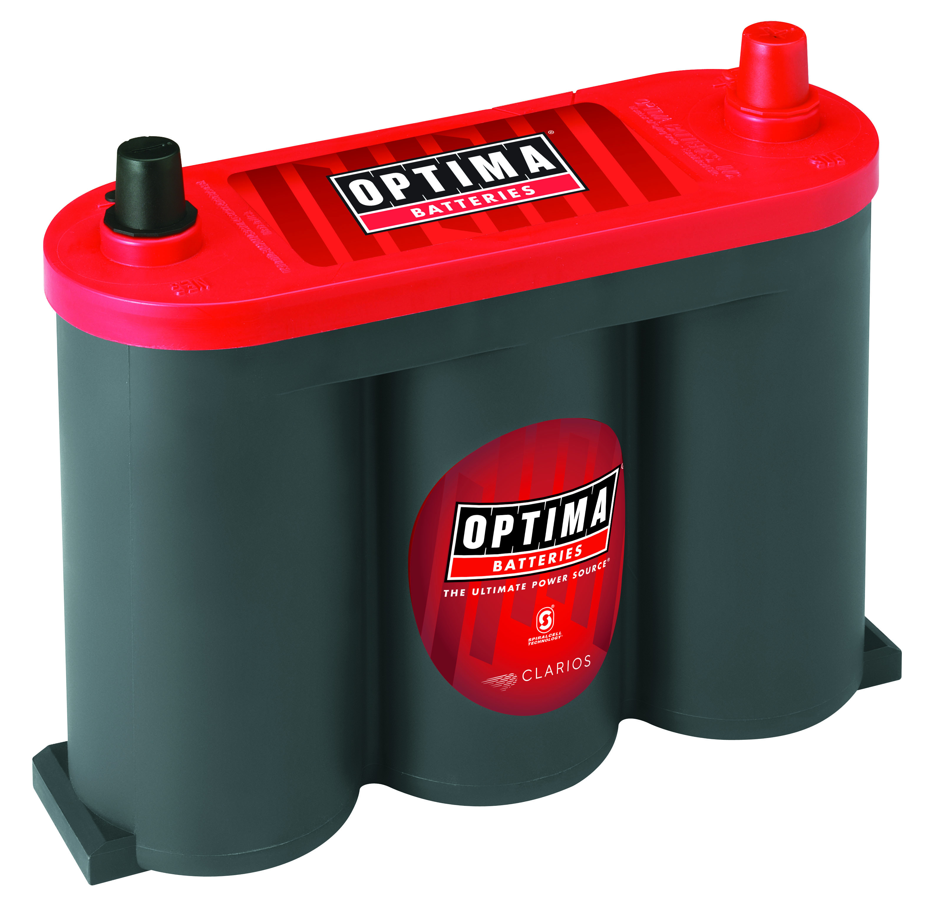

              battery box issues
              and it can get through the hole...
              but I dunno, I've threatened before to put it in the engine compartment - but even there has issues (too close to heat)...

                      • 24117
                      #1660
                      Have seen some use two of these in series when faced with the issues you are having.... Click image for larger version

                        battery box
                        and there it is... means the 'floor' is a bit taller, but since that area is pretty much useless once the roll bar is in place.... no biggie
