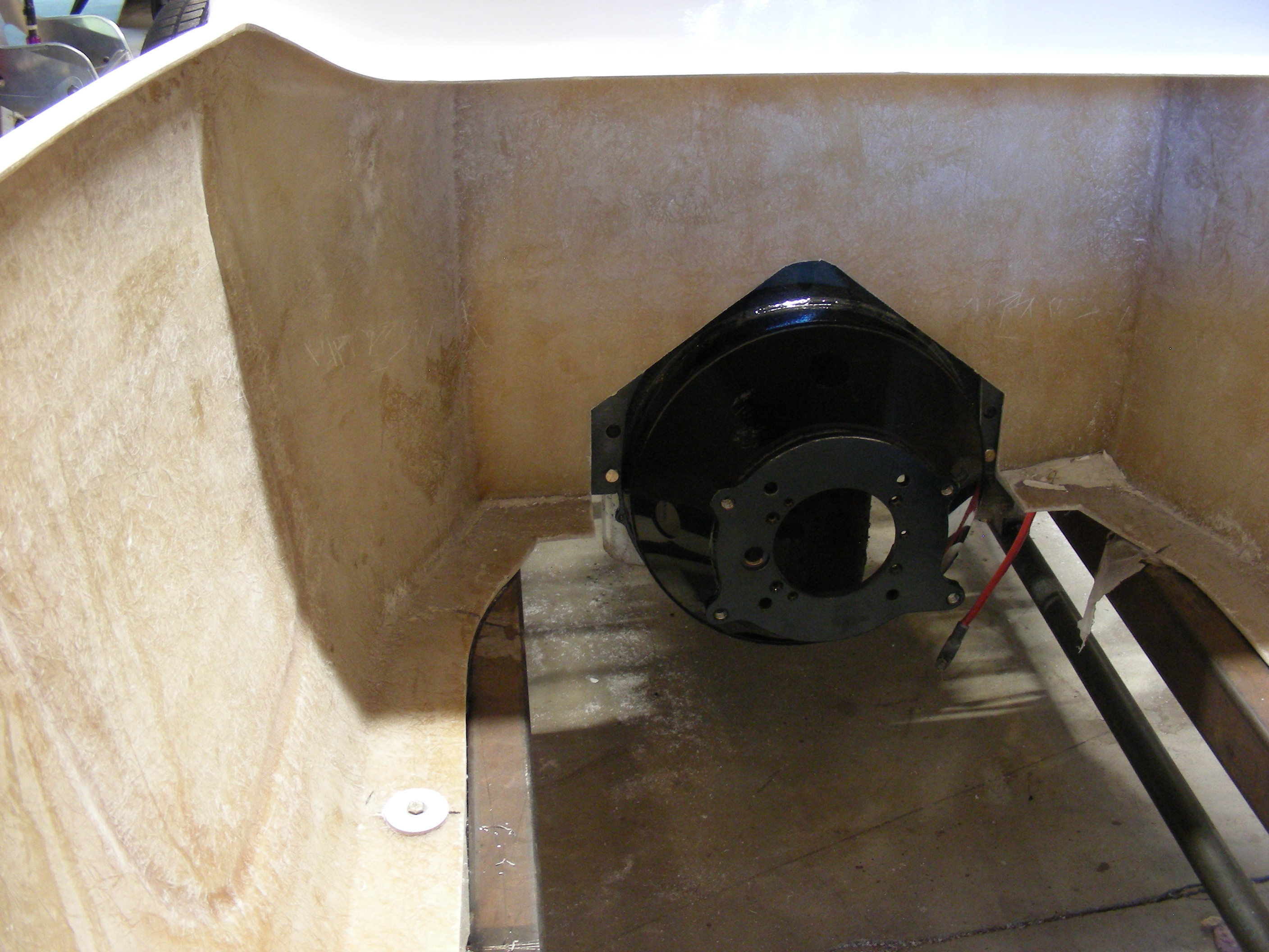

                      Put old mangy back in the frame today. Click image for larger version
ID:	1305754 Needs to go back a little bit more. Like right up to the firewall. Next I have to get the T5 and make a rear crossmember to support the back. That way I can get rid of the side mounts I was thinking of using.
                      Looking at the inside clearance to the bellhousing cutout seems to show enough room for 3 pedals and my clown feet down there.
ID:	1305755 I still have to figure out how to make some internal support structure to support the steering column. And the pedals. And all sorts of other unknown stuff that I just know I don't know yet...
