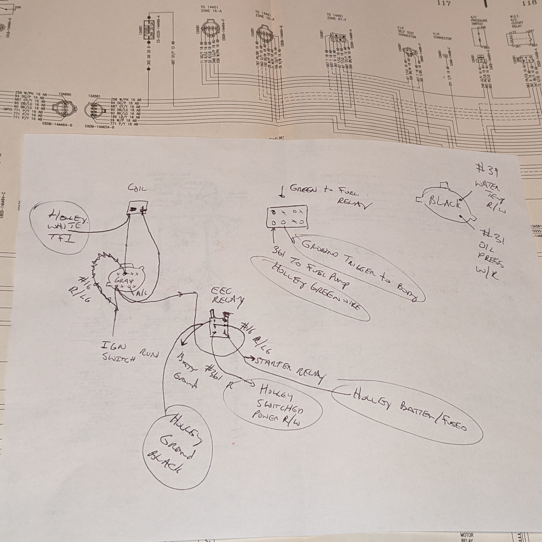

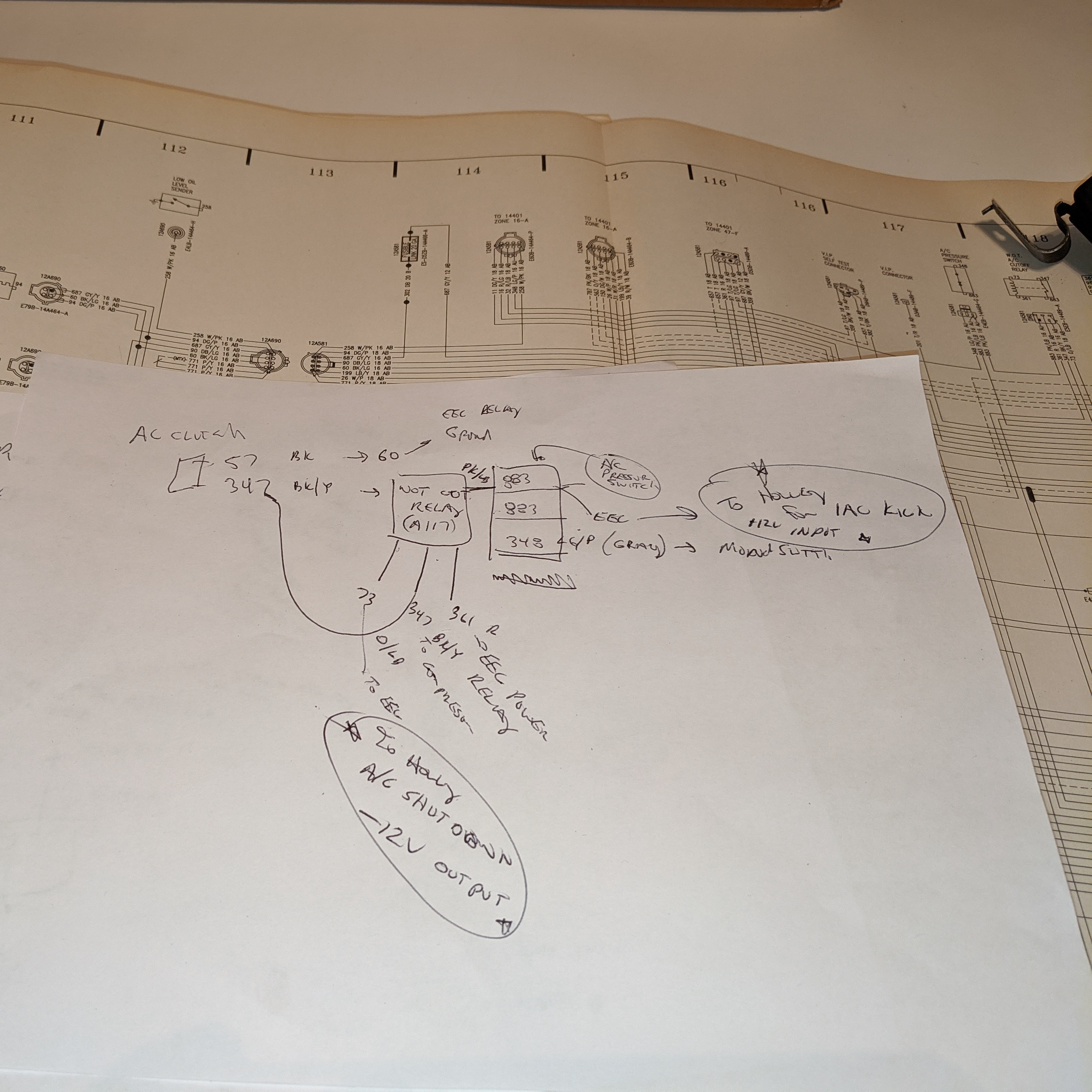

            I don't want to say how many hours I have looked at wiring diagrams. I think I figured out how it was wired and a way to get it going again. I have a few questions.
            Ford powers the AC relay from the eec relay and both relays use same ground, is the Holley ok with that or should I add another relay.
            The Holley instructions called for the coil to be powered from a relay. I didn't see on in the Ford diagram. Should I add one in? This based on a 1989 wiring harness / dash.

              I always figure that it can't hurt to add more relays and/or more grounds. You should see the relays in the Volvo! So when in doubt, add!

                I put our coil on a relay. It and the fuel pump relay are controlled by the same switch. Is it necessary? Probably not, because I can't think of any car I've ever owned that had a coil relay.

                  I have one sitting here, might as well put it in. Should I fuse or fuse link it?

                    Mine is just fused.
