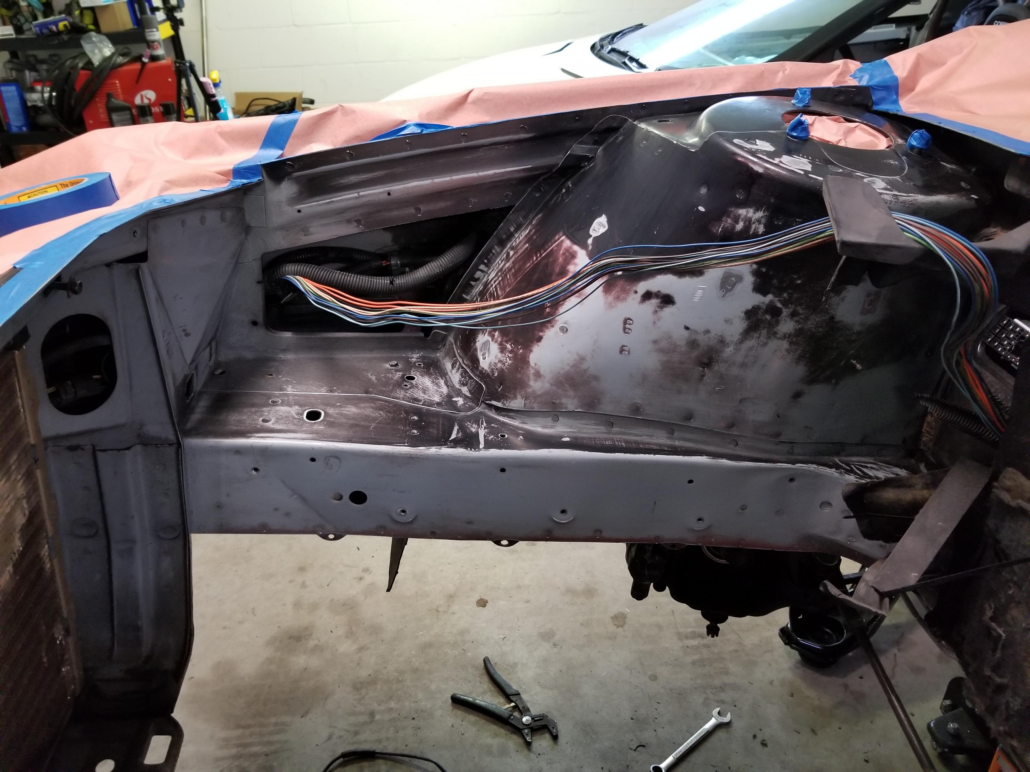

I've been lacking motivation lately but managed to get out there and knock out a few things.
Wire wheeled the goo off the subframe to paint it.
First coat.
Done. Not perfect but then again I wasn't going for perfection. Much better than it was though.
i was surprised at how little paint was actually in the engine compartment. I guess Gm was saving pennies by lightly misting some color in there.
Primed.
Painted.
I'll just spend 5 minutes and roll this around to the shed so I can....!@#$...... Caught a pebble at speed and went for a tumble.Oh well. Just made the front pulley D shaped.

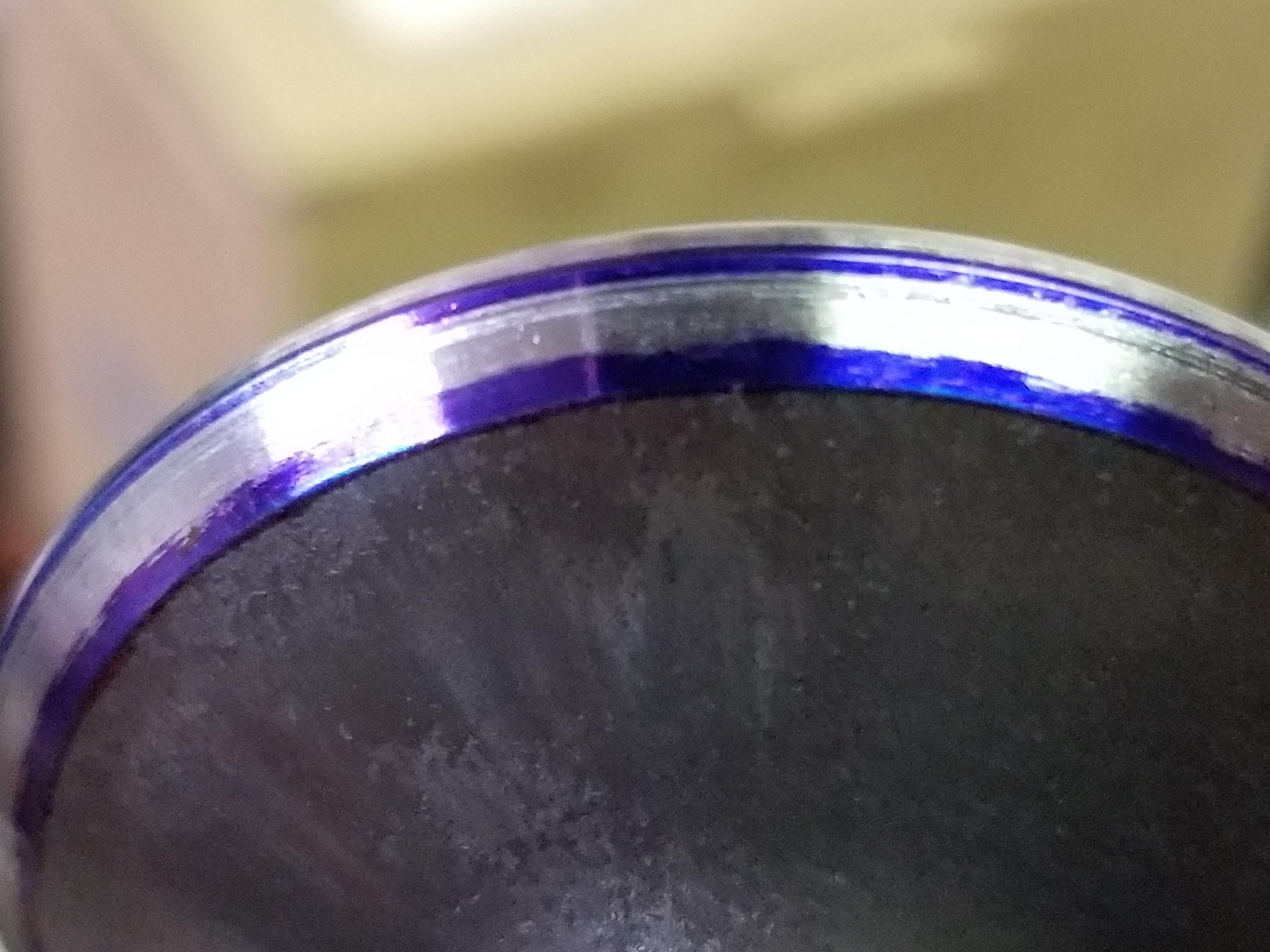

Look at that margin difference on the exhaust valve. Left is a melling stock replacement. Right is a stocker with one grind on it. The left one disgusts me.
smidge too high...
dead f'n center. A 30 on top and a 60 on the bottom of the seat to narrow it up and we are good to go!
Aftermarket valve with no back cut
Stocker with the back cut.
