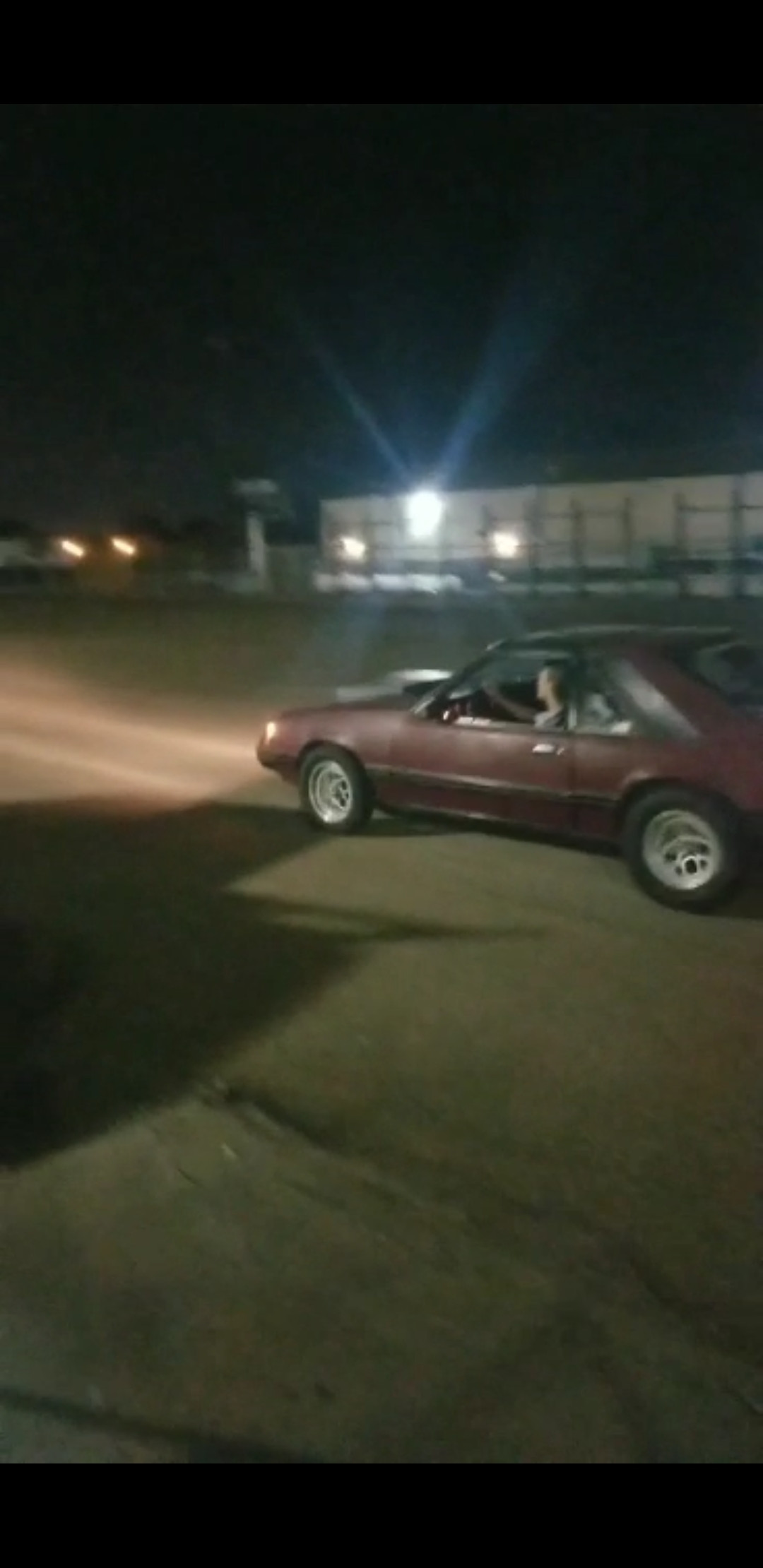

Whoo hoo! It moves and stuff!

Once we took care of that, we fired it up on the jack stands and shifted it through the gears for a few times. Then we put it on the ground and Judd pulled it out of the shop and made a few laps in the parking lot. I think the fluid level is a little low but the car moves and shifts and generally does the stuff it's supposed to do.
